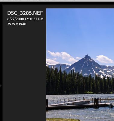

Look, this really isn't rocket science. Simply press Cmd-J while you are in the develop module. You will be presented with a dialog where you can specify what will be displayed in two different loupe displays on your screen. You choose what will be displayed on each line. In info 1 you can choose to have it show briefly when the photo changes. At the very top of the dialog box there's a checkbox if you want one of the info displays to show all the time. If you don't, then don't put a checkmark i

If you want to see the pixel dimensions while working on your image in the Develop module, it depends on how you have view options set up under the view menu. But you can have the pixel dimensions displayed constantly if you choose to do so.
Yes, this was a really old image taken back when I had a Nikon D40.

The Metadata panel is only available in the Library module. (your screenshot is from Develop)
If you can't see it, go to Window > Panels > Metadata, or press Cmd + 4.
You can also right click one of the other panel headers and choose Metadata from the context menu.
As mentioned by @JP Hess there is a way to display pixel dimensions in Develop.
Press Cmd + J to configure the view options in the Loupe view tab.
Choose Cropped dimensions for one (or both) of the Loupe Info sections.
Press I to cycle through the Info overlays when viewing images in Develop.
To hide panels in Library, follow the procedure I described above to show the Metadata panel.
In Develop, right click one of the panel headers, and choose Customize.
Hide panels by unchecking them. You can also rearrange the order by dragging and dropping.

I don't want to belabor my point. When I'm working in the develop module I usually collapse the left-hand panel, using the mouse to expand it when I need a preset. In that configuration the information doesn't show over the image content. That's why I like to use it that way. Actually, I have it configured to display briefly most of the time when the image changes. If I need to see it I can always press the letter I to toggle the information on as needed. As I say, everyone has their own way of using Lightroom, just defending why I use it the way I do. If you don't like my way, that's okay. Don't use it.
