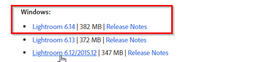

You have to download the installation files from here: Download Photoshop Lightroom
First download an install Lightroom 6. This is not the actual version. I think it's 6.1
In the next step you have to download and install the update to version 6.14. You'll find the update on the same side.
MacOS
Windows
If this doesn't help please described exactly what you've done an which error messages you get. And please post the version of the operating system you are using.

You have to download the update file manually. The update files you'll find on the same site which contained the installationfile for LR 6. See the screenshots in my previous post.
For Windows it is a zip file which contains the appropriate data and the AdobePatchinstaller.exe. You have to unzip the setup.zip first and the start the AdobePatchinstaller.
For Macs there's a setup.dmg. I'm not a Mac user and so I don't have any experience how to install software from a dmg file.

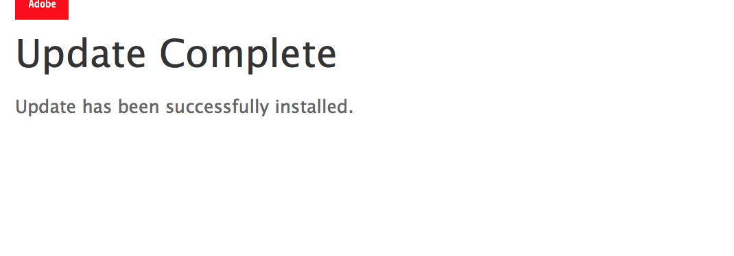

Thank you!!  I actually downloaded this 3X.  It goes through and says its successful, but LR is still stuck at V6 (no update applied).  Ive restarted, and still nothing.  I would have thought it would have given me a zip file or something, but Nada.  Im just stumped on this one.  Appreciate the responses and trying to get a resolution.  Maybe Im doing something wrong on my end.  Ive actually uninstalled LR6 and reinstalled still with no luck.  Dont know why they make it so difficult!
New Here ,
Jan 28, 2019 Jan 28, 2019
