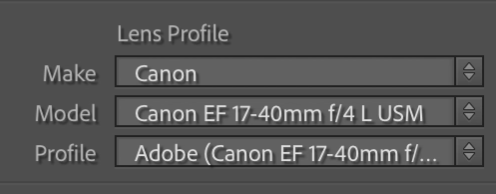

The make and model is correctly applied to photos automatically. Profile had always been applied consistently as well. However, there are two options for profile and LRC applies different ones to different images. It also seems like it might be changing them back after I try to switch all images to one so I can blend them by hand in PS. When I go into PS I notice that they're not aligned properly and it's because there is slightly different distortion on some of the images. I go back into LRC and some are on one profile and some are on another and I have to change them back. I've even seen them switch automatically to another profile while I am looking at them and not touching anything in LRC. Why would this be happening? It was never an issue before and I've been using this workflow and camera gear for years.

It varies between these two. Each one has an option in that third category and Lighroom changes it on some of them and not others but all were from the same camera on the same lens taken within the same composition (I'm compositing images so they were all taken seconds apart within each batch). I'll get into PS after a export as layers in PS or whatever that option is in LRC and all will have one profile except, say, one image and it will ruin the compositing I'm doing. Then I go back to LRC to investigate and as I click through the individual exposures I'll see LRC changing the Profile to the other one in front of my eyes. I also tried preemtively changing them all after I noticed so that I could export to PS without issues but that didn't stop LRC from being wonky still. So to answer your question, it changes it automatically but I also manually changed it as a way to just get through my work today.

As far as I can tell the first screen capture is the profile for your lens. It was first introduced with the original Lightroom 3/ ACR 6.1. You should set it as the "Default" see the screen capture.

The Adobe (Canon EF 17-40mm F/4 L USM) profile was created on full frame camera whereas the other version prefixed with Canon EOS-1D Mark III was created on a cropped sensor (1.3x) camera. Since you're using a Canon EOS 5D IV, you should set the Adobe (Canon EF 17-40mm F/4 L USM) profile as the default.

Your videos indicate that the 'Adobe (Canon EF 17-40mm F/4 L USM)' is set as the 'Default' for some images and not others. Therefore, you'll need to choose an image where the 'Setup' dropdown menu shows 'Custom', then use 'Save New Lens Profile Defaults' as demonstrated in attached screenshot.
