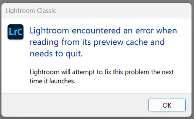

Some more detail.  I discovered that LrC can crash on startup with Google Drive doing a sync.
The error from LR was:
Google Drive sync was running but my Synology NAS Drive sync was paused.
There were Lightroom files showing up in the Drive sync queue, but I am not sure if they were there before or after the error message window from LR popped up.
