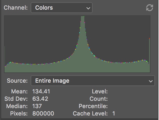

But what happens to the 8 bit image data after applying toning edits. Here are histograms of a Kodachrome 64 slide captured with a Plustek 7600i film scanner. Its Dmax is claimed to be a modest 3.5 and Kodachrome has one of the highest Dmax of any film type so it fits your example. A simple PS Curves adjustment was applied to correct Kodachrome's high contrast and dense shadow areas and the Black and White clipping points set. As bad as this looks it's not visible in the image at 1:1 view, but what about images that need more extreme toning and color corrections? Interestingly the 8 bit TIFF doesn't exhibit the comb pattern in the LR's Histogram. This is due to LR creating a less accurate histogram from a down-sampled copy of the Develop image bit map. You can see the same effect in PS's histogram when it's using the cached image. A small triangle with ! is displayed in the Histogram panel and the 8 bit and 16 bit histograms look identical same as in LR, but it's not the actual image data histogram. In PS you can click on the 'uncached refresh' button to update the Histogram and make it accurate. Don't be fooled by LR's Histogram!
         16 bit TIFF With Curve Adjustment                 8 bit TIFF With Curve Adjustment
May 05, 2018 May 05, 2018
The combed histogram doesn't actually necessarily indicate that the 8-bit tiff after curve adjustments has lower image quality. You might just be stretching noise and you won't be able to see it. This is easy to illustrate by generating a noisy gradient in Photoshop and adding a bit of noise (1% in this case). Then convert a copy of this to 8 bits and apply the same curves adjustment to both images. Here is the curves adjustment:
Here are the resulting histograms (16 bits left and 8 bits right):
You can see that the 8 bits image is all chopped up in the histogram. But look at the images:
They are identical and both equally non-posterized even though one histogram looks terrible. The reason is that the noise is acting like dithering which will hide any possible posterization. If I do this to a non-noisy gradient you do see posterization in the 8-bits image as you can see below for same gradient, same curves but no noise in the original. The histogram on this is basically identical to the 8 bits histogram above but you can clearly see posterization all through!
So if you have noise in your image that surmounts the 8th bit of the image you can safely use 8bits even if your histogram will look ugly after doing strong curves manipulation. The image will be visually identical. I used a 40dB signal to noise ratio above which is very typical for flatbed scanners. You can do much better with a drum scan which uses a photomultiplier tube instead of a ccd to record the image and has a far better signal to noise ratio. For drum scans, go 16 bits!
