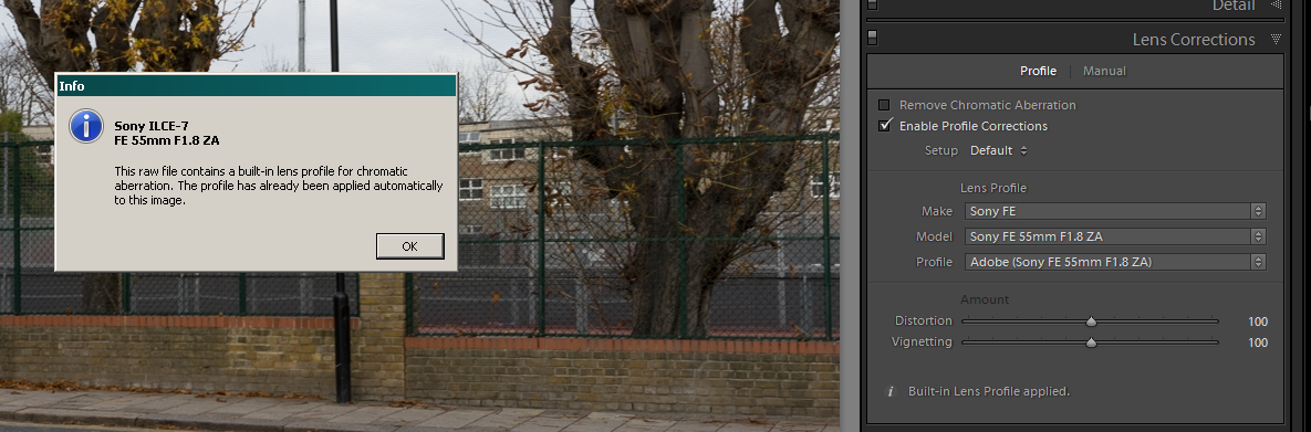

I just downloaded several Sony A7 arw files and in every one of them the Lens Corrections Enable Profile Corrections is checked. So that seems to be the Default for that camera and lenses.
So I personally would stop worrying about it.

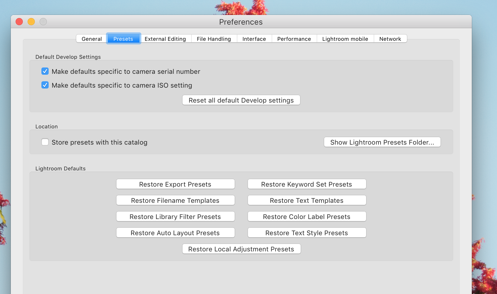

See the screen capture for Lightroom Preferences > presets Tab and check if you have the option to make defaults to be Camera and ISO specific. Possible that this may be affecting the develop settings. My lens corrections is not set to on by default.Screen Shot 2017-03-18 at 8.35.13 AM.png
Just a thought, when you reset the defaults it does not change the previous imports. This is applied at import.
