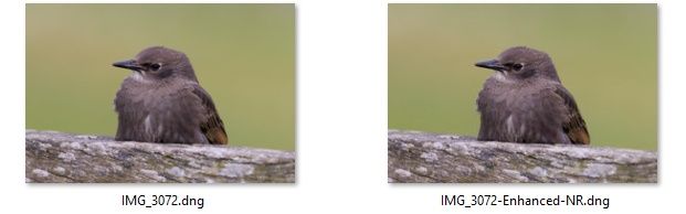

Denoise should work fine on DNGs out of the Adobe converter, Thor:
