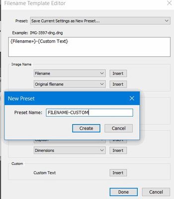

Aug 20, 2021 Aug 20, 2021
My suggestion- Change the Filename IN LIGHTROOM-CLASSIC- After you have used the Ps command [SAVE].
This is far simpler than having to worry about 'where' your files are being saved, and typing a filename in Ps, then imporfting the file to LrC.
So the method is-
1) Edit in Ps
2) [Save] from Ps
3) In LrC Rename the file.
You can use a Rename Preset that will add the external 'editor' to the end of the existing filename.
Example- where YOU enter the 'editor' suffix in the [Custom Text:] panel-
2021-08-21 08_34_23-Filename Template Editor.jpg  2021-08-21 08_34_45-Rename 1 Photo.jpg
This same Preset can be used more than once.
Example, each time the same file 'goes' to another external editor, the Rename Preset appends the Custom Text to the end of the existing filename-
2021-08-21 08_35_34-Rename 1 Photo.jpg2021-08-21 08_35_49-Lightroom Catalog-v10 - Adobe Photoshop Lightroom Classic - Library.jpg
Or, you can create individual Rename Presets for each External Editor- Thus NO typing of filenames is required. It is a simple [Press F2], Select the appropriate Preset.
One small point with this method- In Preferences > External Editing: Set the Template to [Filename] to avoid a default suffix being appended. (but complications can occur with the OS adding -2 -3 etc)
Regards. My System: Windows-11, Lightroom-Classic 14.5.1, Photoshop 26.10, ACR 17.5, Lightroom 8.5, Lr-iOS 10.4.0, Bridge 15.1.1 .
