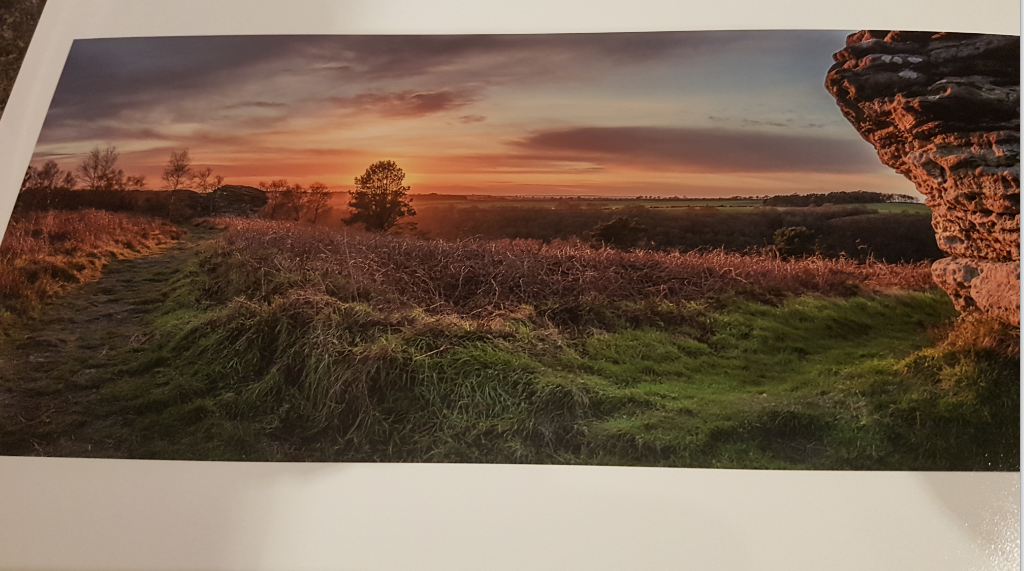

New Here ,
Feb 25, 2018 Feb 25, 2018
Jim/Laura
Just for reference
Above is how its printing
And this is in Lightroom.
LEGEND ,
Something is definitely off, that's for sure. If you're using Windows, have you used their so-called calibration tool to adjust the monitor as best you can?

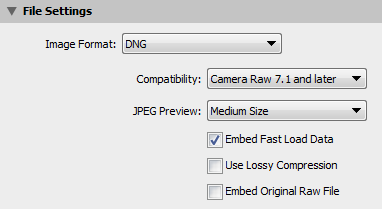

We can do a first-order check of  your display calibration with the image file used for the screenshots in your reply #11. Export the original file with your Develop settings to DNG file format using the below settings and post the DNG file on Dropbox or other file sharing site. We can then compare it to the posted picture of the print.
