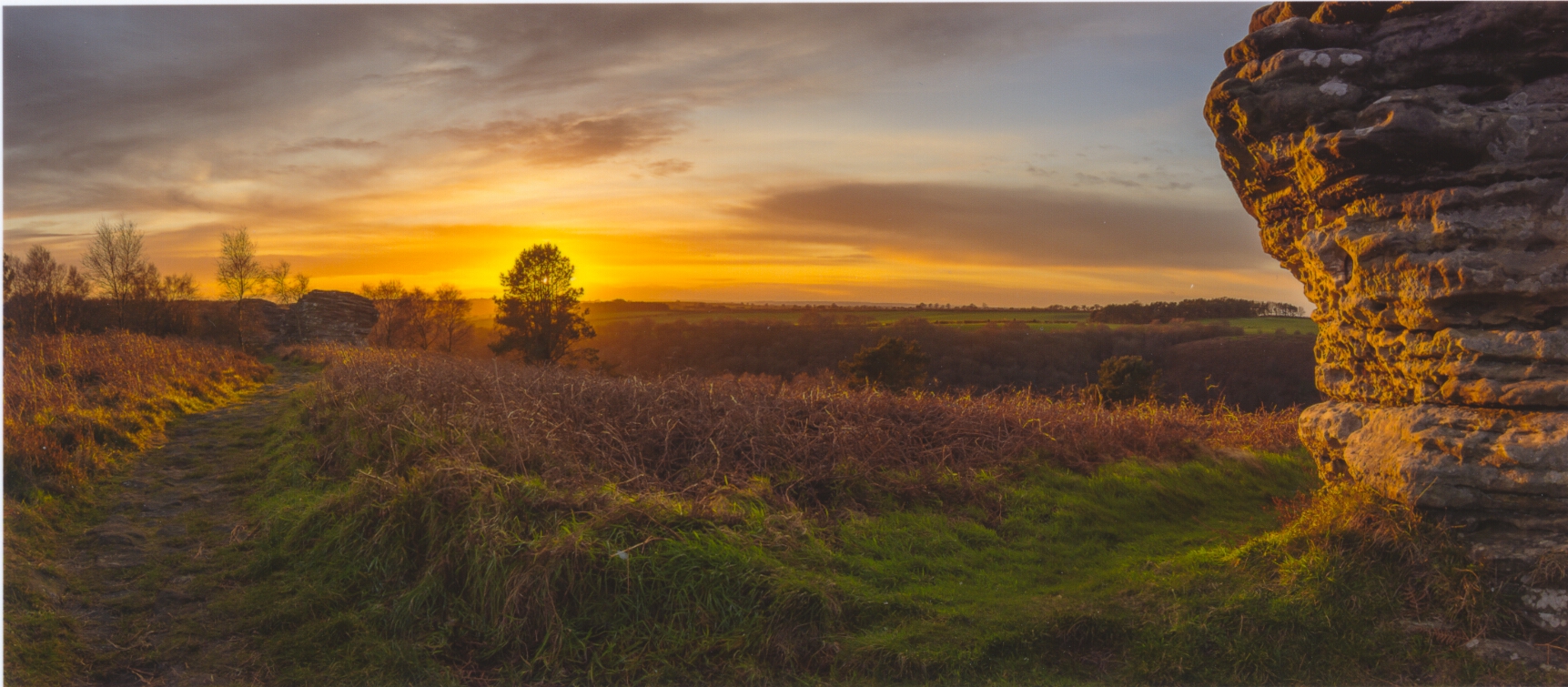

The actual camera shot image - is that the image I took of the print?
Cheers

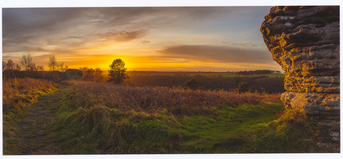

Here is what my Canon Pixma Pro-100 printed. This is a scan of the 4 x 6" print that I did on some Red River glossy paper.
I apologize for the sloppy trim job. Didn't take the time to trim it up.
Jim, it looks very close to the LR Soft proof using the RR UltraProGloss profile for CanPro-100. There is some contrast buildup, but that's probably due to the scanning process. So what LR settings did you use?

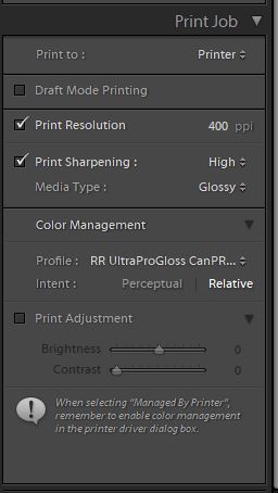

Oh, I see what you mean. Are these the relevant settings? The other settings are just margins, and you probably don't need those.
I used Red River Ultra Pro Gloss paper. As per their instructions, I selected Photo Paper Plus Glossy II in the paper type in the printer driver. And I turned color management off in the printer driver.
I printed two copies, one with no added saturation and one with the 25% boost. Frankly, I can't see much difference between the two.

Looking at the DNG original file, LR screenshot, and picture of the print on my calibrated monitor it's clear the printer color management is at fault. There doesn't appear to be any significant calibration issue with your laptop's display. It is very close in both Luminance and color calibration to my display.

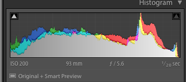

I am having a similar experience with my Canon Pro-10S printing from LR CC. I am using the correct paper profiles and while my 27" iMac is not calibrated I am confident that it is not far out. Most of my prints come out pretty good to excellent.
However I have one family portrait taken at sunset with lots of warm oranges and reds. On the screen I have pushed these a bit by raising the colour temp to 7500 however when I print it it comes out quite dark with very intense reds. To get a decent print I have reduced the temp to 6000 and desaturated the oranges by -6in the HSL panel.
The on screen image looks quite washed out with soft proofing turned on but there is a clue in the histogram which shows a strong shift to the right in the reds as you can see from these screen shots. The first is with soft proofing turned on after I have made the changes above. The shift is much more pronounced in the original version. The histogram is telling me what to expect and that is what I get - very saturated reds. However the screen image gives no indication at all.
I am inclined to think its a bug in the soft proofing.
