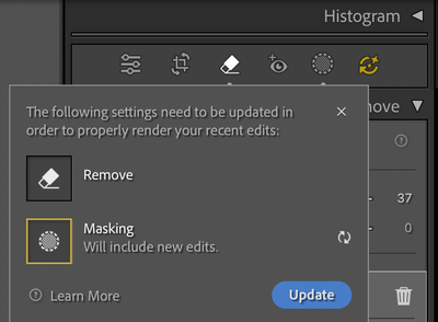

LR's rendering was designed with the intention that the Remove tool (including Heal and Clone modes) would be applied first, and then you'd apply masking.  The AI masks are generated based on the image after Remove has been applied.
But when you apply masking first and then Remove (which is often a more intuitive order), LR will warn you with the orange circle icon, which shows this when you click it:
When you click Update, LR will then "properly render your edits".  Often there isn't much change, but sometimes, as with the leash example, the changes are quite noticeable, since the masks get recomputed, taking notice of what was removed (or healed or cloned).  (Prior to LR 14.4, the need to update AI settings was indicated with red dots.)
So you should get in the habit of always updating the AI settings whenever the orange circle appears so that LR has "properly rendered your edits".  Otherwise you can end up with surprises like your face example.
