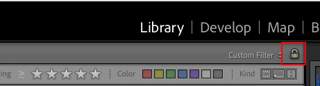

When viewing my images in the Develop module with a star filter rating, I have been commonly running the new Ai Denoise feature.  It is really great!
My one gripe is that everytime I choose to run Ai Denoise on an image it removes my star rating filter and I have to apply it again.
This is truly a minor incovinence and my hopes are that in writing this is that someday there will be a patch and it will save me more time in the future than it took to write this.
May 21, 2023 May 21, 2023
You can already do as you ask by using the lock at right hand side of the filter bar. I've attatched a screenshot shwoing where the lock is located.
