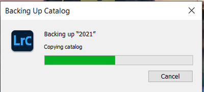

I have same problem with USB HDD and LRC 10.2 & windows10:
Photos are in 3TB usb drive which is connected to USB3.
Catalog locates in my pc ssd drive. Catalog backup location locates in usb drive.
After closing LRC catalog backup process stuck about 50%...
It will continues, if there is not any changes/adjusts on pictures...
