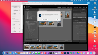

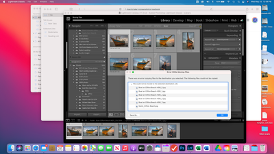

After I drag a folder (thru LR) containing about 165 photos to a Photos folder on Google Drive I get the following screen:
If I try to drag the folder again to the same location i get the following:
Trying to import one of these photos on to the Google Drive Photos folder gives me:

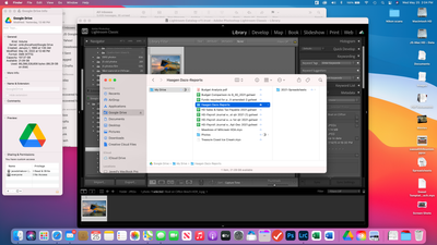

I forgot to mention above. When I look at Finder, Google Drive shows a circular icon next to it:-
Does that icon mean it's still working?

Thanks for all the information here! This is great. Starting with your last post about the icon question. That pie chart is showing the status of the current copy you are doing. It will fill with gray as it completes.
