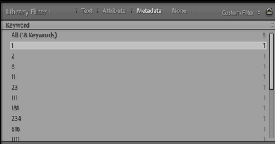

- Use the Keyword column in the Library Filter bar's Metadata browser:
- If you've got lots of keywords, the Keyword column is quite painful to use, with its tiny scrollbar and no ability to filter the keyword list.  Instead, use the Keyword List panel, typing the desired keyword in teh Filter Keywords box, hovering over the keyword, and clicking the right-arrow that magically appears on the right (magically appearing buttons are always a bad UI design):
- Use the Filter By Keyword command of the Any Tag plugin (which you can assign to a keyboard shortcut), which incrementally filters the list of keywords as you type, so it's very fast to select the desired keyword:

You're absolutely right that the Keyword list is painful to use. This was one of the solution I've been trying, but the main problem is that it searches throughout the whole catalog, not in a particular folder. So searching for keyword "1" will return results from all the sport events I've shot where there was a photo tagged with number 1, obviously this is not the result I am looking for.
I will surely give Any Tag plugin a try, but judging by the screenshots, it looks like it solves a slightly different problem (getting your way around the keywords list), while I guess it will return the same search results. But let's give it a try first I and I will give you my feedback. I will also make sure to add the details of my problem to the bug report, so hopefully someone will pay attention.
LEGEND ,
Jul 25, 2021 Jul 25, 2021
"I will surely give Any Tag plugin a try, but judging by the screenshots, it looks like it solves a slightly different problem (getting your way around the keywords list), while I guess it will return the same search results."
Any Tag's Filter By Keyword command uses the Keyword column in the Metadata browser, so it will return correct results using exact keyword match.  The advantage of the Filter By Keyword command over the Keyword column is that it is faster to use when you have more than a few dozen keywords.
