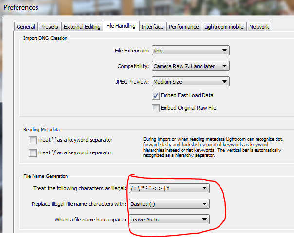

Here it is inside LR CC 2015.8 on my Windows 7 system:
Change your LR Preferences as shown below and it should work.

"File Name Generation" is confusing nomenclature since (according to Adobe) the rules are applied on import, so it's really generating the internal names for the catalog from names of the files being imported.  The only illegal character in my filename is the colon, which should have been changed to a dash. So my  DNG should be imported into the catalog with only this one alteration to its name.  But instead it just disappeared.  What am I missing?

The rules are also applied on Export and the : is replaced automatically with a -. It's Windows reserved character:
Naming Files, Paths, and Namespaces (Windows)
It's not possible to "manually" rename a file with a colon on a Windows system. So I'm not sure how you even created a DNG file with a colon in the filename. Try changing your LR Preferences as shown in my reply #5, export the file to DNG format again using the same renaming {Filename>>}_{Copy name>>}. It works for me.

My mistake: the file WAS successfully imported even though I killed the import during preview generation.  I accidentally imported it into the wrong folder.  The name after import is
_DSC4751_cifa_4900_baryta310_p_bk.icc (Media Setting - Premium Luster 260), Perceptual.DNG
so the colon was changed to a dash on import.  Mystery solved.
