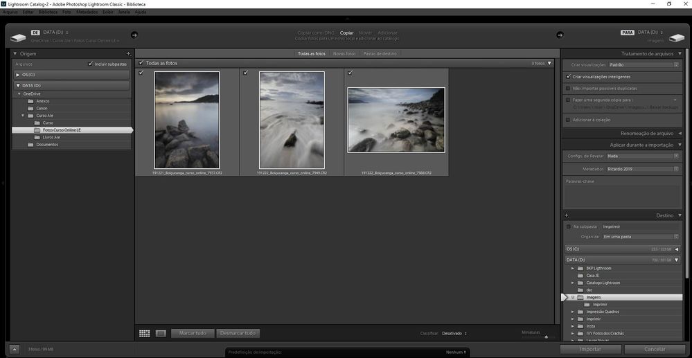

This is the exposure I have during importation.

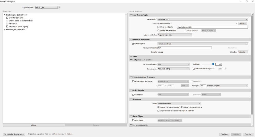

This is the export configuration screen
