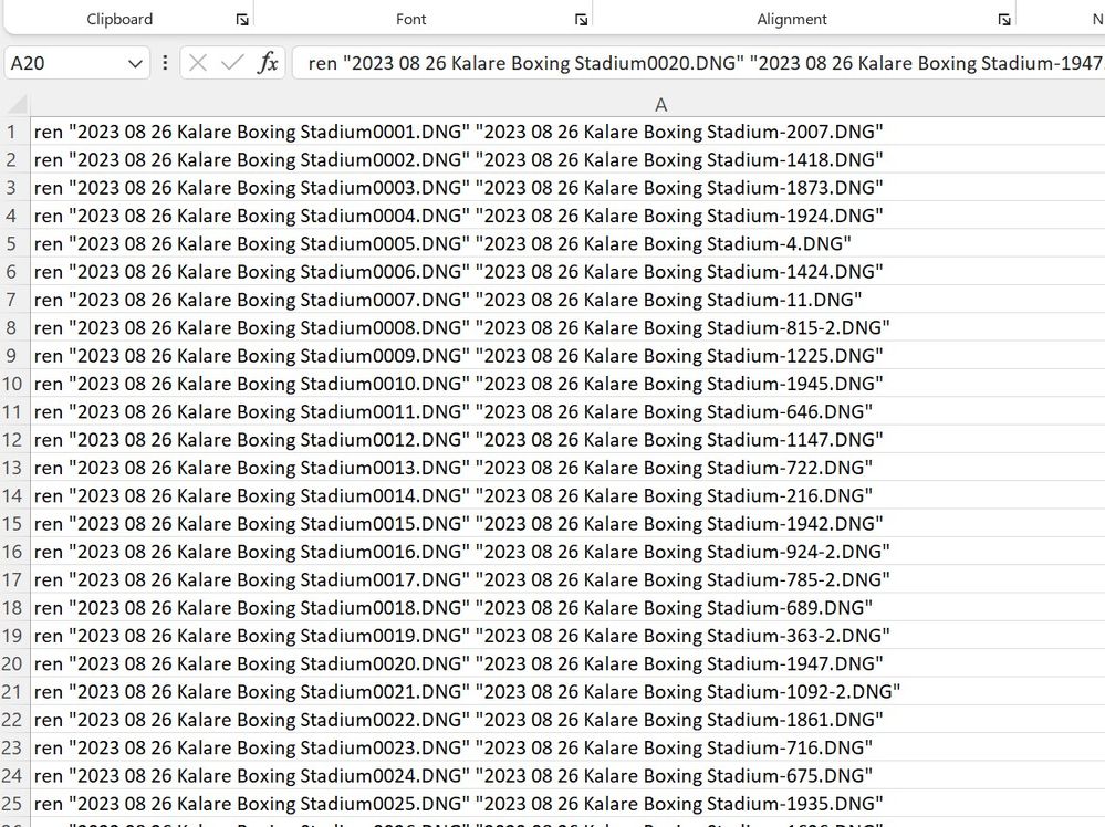

Sep 01, 2023 Sep 01, 2023
I was able to fix this problem. Within Lightroom I exported all the photos with the original name. I then copied all the exported file names in an excel column, I also copied all the names of the raw file that were renamed outside of Lightroom into another column. I then combined the columns, along with some rename commands to be used in CMD and pasted everything the CMD and ran a batch rename command that restored the old names. Lightroom now shows my photos are original + smart preview.
Example of the CMD command, including another 2000 lines:
ren "2023 08 26 Kalare Boxing Stadium0002.DNG" "2023 08 26 Kalare Boxing Stadium-1418.DNG"
ren "2023 08 26 Kalare Boxing Stadium0003.DNG" "2023 08 26 Kalare Boxing Stadium-1873.DNG"
ren "2023 08 26 Kalare Boxing Stadium0004.DNG" "2023 08 26 Kalare Boxing Stadium-1924.DNG"
This YouTube video explains the Excel part:
https://www.youtube.com/watch?v=znhqGrF4gVQ
