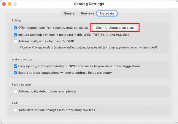

There are a couple of things you can do. This is what I could think of, others may have more ideas.
The type-ahead auto-fill text comes from “suggestion lists” that it learns from you. You can reset these in Catalog Settings. Of course, that means auto-fill might not work for a while as it builds up the lists again from scratch.
If it’s trying to auto-fill a bad keyword, you can search for it in the Keywords List and then delete it. In my example, somehow the non-word “ironi” got in there and I don’t want that to be suggested during type-ahead, so I right-clicked it so that I can choose the Delete command from the context menu that appears.

Thanks Conrad!
I already knew about deleting keywords, so that isn't an issue; I've fat fingered those many times and fixed them.
I reset the catalog settings, so we'll see if that works.

And, it worked!!!
Thank you so much!
