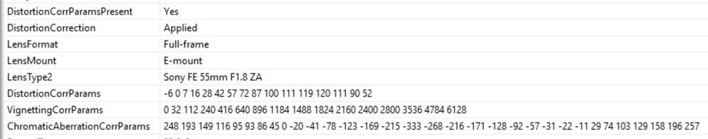

The lens profile appears to be embedded in the raw file (see below). Whether or not it's in a standard format I have no idea. Regardless, if it deviates from "standard" built-in lens profiles why hasn't Adobe provided guidance on this and how to use it? Micro 4/3 cameras were the first to use built-in lens profiles, but even with those camera the lens profile doesn't always contain distortion and/or vignetting lens correction data. So it looks like the user will need to check the 'i' built-in lens profile information to determine what is corrected with the built-in lens profile and what needs to be corrected with the LR lens profile corrections tool. Below is an example of two different built-in Fuji lens profiles.
It gets even stranger when looking at cameras like the Canon Powershot G9x MKII, which has no LR lens profile available (shows as 'Built-In in Lesn Profile selector). The built-in lens profile info (i icon) for this camera with a fixed zoom lens says distortion and chromatic aberation only. However, after examining hundreds of pictures shot with this camera I see no vigenetting–So where and how is it being corrected?
