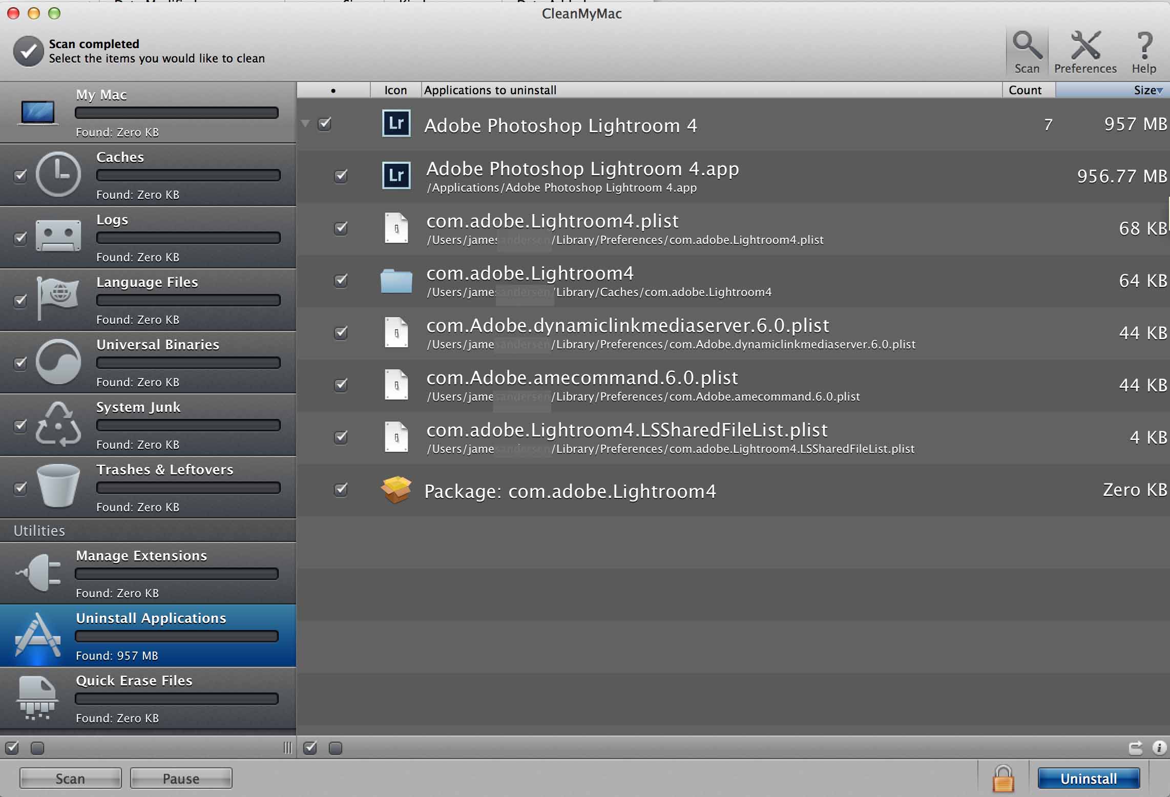

If you don't have Photoshop another thing you can try is download a demo of 'Clean My Mac' and uninstall lightroom from that. You will need to click on the uninstall tab with in 'Clean my Mac' and then DRAG the lightroom APP to that uninstall window. I'm not 100% sure if the demo will let you uninstall the whole thing or not.
I bought the full version and I love it. I had problems with another application and uninstalling manually didn't solve anything. Clean My Mac removes EVERYTHING associated with the program including all of its extensions. This is great because that does not happen when you simply delete the APP into the trash bucket like normal in OSX. Actually, I will show you where all Lightroom's junk is via screenshot below.
