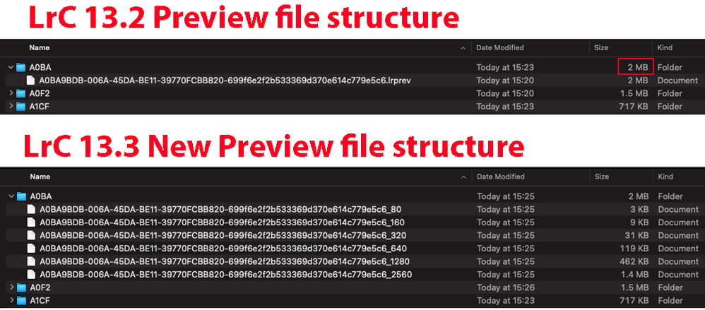

Fwiw, the only time I've seen a duplicate previews.lrdata folder is when the upgrade process went wrong.  Also worth noting that the structure of the preview files for each original is different. The preview structure in 13.2 and earlier was a pyramid of X files of different sizes. In 13.3 the preview structure for the original file is X separate files of different sizes. I've attached a screenshot that might make more sense than my description.
Note that I also tried your suggestion of taking the original previews.lrdata and renaming it to include -v13-3. However, when I launched LrC 13.3 a new previews-lrdata-v13-3 was created and the grid cells were all grey.
Jun 05, 2024 Jun 05, 2024
Interesting. Definitely something buggy there. I've seen a duplicate previews.lrdata when the upgrade hasn't been able to copy over the old previews, so it's gone ahead and created a new one, as in this case. But every time I've tested, deleting the "new" previews and renaming the old one has worked. The old preview structure gets replaced with the new one on the fly when new previews are built so that in itself isn't an issue. Are you in the Dark Room tonight? It's on my list to ask Rick.
