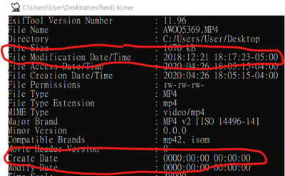

Hey livin1965, I've had this issue for years but never had the time to research this. I finally have the time now since we're all stuck at home and I found this thread. thanks to Johnrellis I used exiftool and see that there's a metadata name "Create Date" that's all zeros. LR is reading that when importing so these files gets copied to 1904. Where the created date or modified date that we see when we go to the properties of the file is correct, that's stored under the metadata "File Creation Date/Time" and "File Modification Date/Time". So if "Create Date" is present in the file, LR will read that instead of the "File Modification Date/Time". The files that gets imported correctly for me DOES NOT have the metadata "Create Date" on them. So I downloaded Bulk File Changer and it allows me to copy the date I want which is "File Modification Date/Time" to "Create Date" and now LR is able to import them to the correct date folder. In Bulk File Changer, you need to choose "Media Files - Date Encoded". That is the "Create Date" field in your file.
