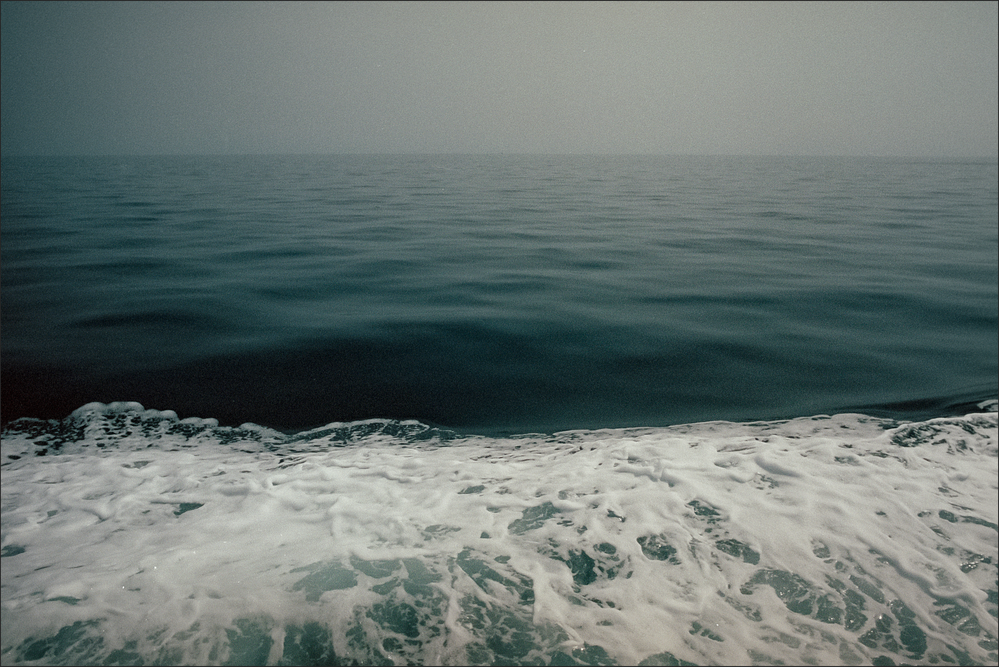

Here's what it looks like.
Full image - Screengrab inside the LR preview - no artifacts whatsoever

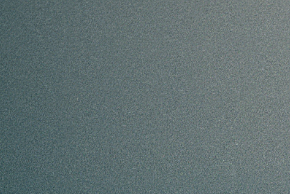

Zoomed in to the sky - Screengrab inside the LR preview - no artifacts whatsoever
Zoomed in to the sky - Screengrab of the exported tif - smudgy blurred lines of grain, acceptable although still compressed looking grain in between
I'm aware that this is the very definition of pixel peeping, but since I'm planning on ordering an high quality, large print I know that this issue will darken my mood everytime I look at the result.
There has to be a way to get an image out of LR without any compressioneske artifacts, right?

To add even more information: I realised that turning off hardware accelaration makes the problem appearent inside of the preview of LR as well. When I turn the hardware back on, I cant see the banding in the preview - unfortunatly when I then export to whatever format I can. Apparently the hardware acceleration is needed to prevent what is perceived as blurry, but is not used while rendering the image to export - is that just my system?
