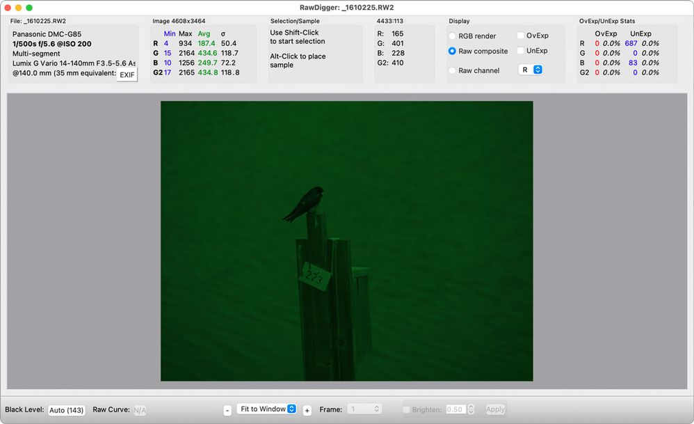

You’re right that a raw file is “unadulterated,” and that’s the root of the issue: A raw file has no inherent appearance. That’s because when it’s raw, it’s just a straight readout of the level of photons received at each photosite of an RGB array on the sensor. So maybe (taken from the picture below) that’s 165 from a Red photosite, 401 from a Green photosite, 228 from a Blue photosite, and 410 from a second Green photosite. (Many sensors have two green photosites in every array of RGB photosites because green contributes much more to our perception of detail than red or blue.)
That raw data must be interpreted to get to the pleasing image we expect, so somebody has to make some judgments about how that data should look. This is where you see the differences. There is no “right” rendering. It’s like if you give identical raw ingredients to six professional chefs and tell them to cook the same recipe, you will get six distinctly different dishes and maybe three of them are “perfect” but in different ways. For the same reason, if you open the same raw file in six different raw processors, how it looks depends on the differing color science opinions of each image engineering team at Nikon, Darktable, Adobe, Capture One, etc.
So if you are asking for a “true” raw image, the closest thing might be an image like the one below, as shown in RawDigger, a technical utility app for inspecting raw files. Of course the rendering looks green, because it’s showing the literal proportions of the actual recorded values, without resolving the two green photosite values into both a single green pixel value and enhanced detail. It also looks dark, because the values are being displayed as recorded (linear) and not corrected for human vision yet (by a standard gamma curve or tonal response curve). So, this is the “real” raw image “as captured in camera,” more or less. Which is different than what most people really want, which is “the image after the camera converted it from raw and rendered it, based on a certain development team’s assumptions and interpretations, altered by the user settings in the camera.”
You might notice that RawDigger also offers an RGB Render option. That looks more like the expected picture, but often not quite, because again, it’s based on a long list of assumptions, such as those shown in the picture below. The only way it’s going to look the same in all software is if every single assumption and aesthetic judgment is resolved exactly the same way by all software, right down to the code that decides how to demosaic values from a raw Bayer photosite array into a single rendered pixel’s RGB value. Hint: Everyone does not agree on the best looking way to process raw, so their raw applications produce different renderings.
