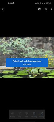

Dec 20, 2023 Dec 20, 2023
It seems like LR doesn't support heic formats transferred from iPhones but I wonder whether it's the problem with LR or it's my Android which couldn't handle the heic images from iphones
New Here ,
I couldn't edit or import the images of heic format transferred from iPhone to Android it either shows failed to load developement version or failed to import
Adobe Employee ,
Hello @mohamed34382168fl1u
Can you elaborate on what camera your HEIC images come from, and what specific Android device and OS version you use?  And also, please describe how you import them, on what device?
I work on the Lightroom iOS product team, and iOS produces HEIC images that I always see smoothly import into LR Android in my experience.
I'm trying to understand which version of Lightroom is having trouble importing HEIC images?  If HEIC images do not display on your Android device Gallery app, then maybe LR Android 'Device' tab (which is a view of your camera roll) might also have difficulties displaying those images... at least until you full import the image.  After importing, Adobe Camera Raw technology built into Lightroom should have no trouble displaying any HEIC image.
If you could share a sample file, and maybe also a screen recording showing your workflow and where/how the problem occurs, that might help us understand what you're seeing.

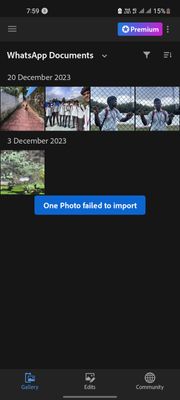

New Here ,
Dec 23, 2023 Dec 23, 2023
The image was shot on Iphone 15 pro max one was raw file the other was heic file. the raw file works like a charm
Both are transferred from Iphone Android as whatsapp document file.
The amdroid phone is Samsung Galaxy A21s running on Android 12 - One UI 4.1.
The raw file works like a charm. The phones gallary displays the heic file
but can't be imported by the Lightroom mobile app. When opened it on the LR app it shows failed to open the development version also if imported it shows failed to import.
The Lightroom version is 9.1.1
