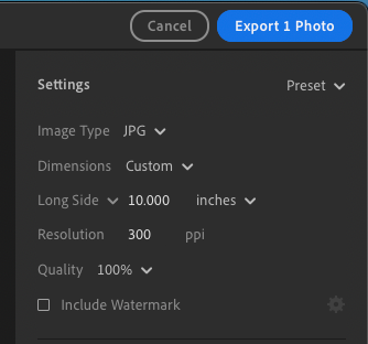

I did senior photos and exported it as a 300 dpi in Lightroom and they said it is a 300 dpi at a 2x4 but i need it as a 8x10. I don't know how to change that if I don't have the right lightroom or what, everything I looked up is not working and I'm unable to figure it out how to change it to a 8x10 in lightroom.
Jan 18, 2024 Jan 18, 2024
Give this a try:
1. Choose File > Export
2. Under Settings set Image Type to JPG
3. Set Dimensions to Custom
4. Change pixels to inches
5. Set Long Side to 10
6. Change Resolution to 300
7. Set Quality to 100
Like this:
Assuming your image size is large enough and cropped for 8X10, this should work.
I hope that helps.

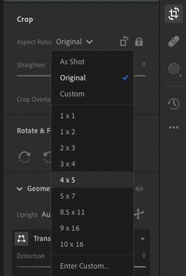

Thank you! How do I know if it is cropped for a 8x10 or how do i do that?
Ok...
Choose the crop tool then choose 4 x5 from the Aspect Ratio drop-down menu.
Like this:

Then I assume I enter a custom one since there is no 8x10?
quote
By @Makenna33618605ps53
You can, but you don’t actually have to, because 4 x 5 and 8 x 10 are the same aspect ratio. Note that this is not a physical dimension, it’s just the ratio of one dimension to the other.
If you crop to 4 x 5, and your goal is "8 x 10" not as a ratio but as a real-world physical measurement (8 inches by 10 inches at 300 ppi), the 4 x 5 crop will become that at export time, using the steps Rick showed (set Units to Long Side 10 Inches, then set PPI to 300).
The problem with the original 2 x 4 aspect ratio crop is that at 8 inches, that can resolve only to 8 x 16 inches or 5 x 10 inches, never 8 x 10 inches (because 2 x 4 aspect ratio is the same as 1 x 2, the long side twice as long as the short side).

Dec 02, 2021 Dec 02, 2021
Where I can change the size from cm to inches to get 300 dpi?
Choose Export as with custom dimentions. As I am typing this on my iPad, I can't post a screenshot but this should really not be hard to find...
-- Johan W. Elzenga
Found a screenshot on the web. After you choose Custom dimentions, you should see this:
Change pixels to inch and you should get a resolution field in ppi.
-- Johan W. Elzenga

Helping with screen-clips:  in Lightroom-Desktop v5.0
1) Choose [Custom Settings]
2) In Dimensions: select [Custom]
3) Change  'pixels' to [inches]
4) Enter your [Long Side] and [Resolution =300]
And it is PPI 'Pixels per Inch'.  (DPI is 'Dots per inch' that refers to the printer dots of  ink sprayed on paper.)
