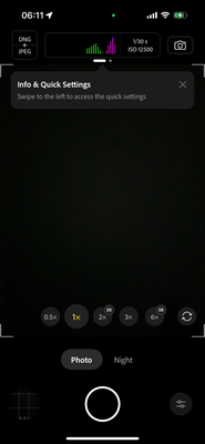

I am really excited this app but as I was trying this app on my 16pro, it seems not working and only showing a black screen. Wondering if there's any solotions?
Adobe Employee ,
Jun 18, 2025 Jun 18, 2025
Hello - thank you for reaching out, and sorry for the troubles you are facing. Can you share some more information about the symptoms you are seeing: is the UI also frozen or does tapping on buttons do anything, which country is your device/Apple account from, how long have you tried leaving Indigo with the black viewfinder?
There are 3 things you can try:
  • Try to run the native camera app and then switch back to Indigo.
  • Try to restart the device.
  • Try to completely remove Indigo and reinstall from scratch.
Let me know if any of these helped, and thank you for your patience!

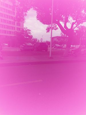

I'm observing that photos taken with my iPhone 15 Pro's camera are displaying a pink tint. Has this issue been reported by other users? My device is running iOS 18.5.

Hello - thank you for reporting the issue. This is not previously known to the team: can you share a DNG with us so we can inspect it in more details? Also, can you share some more details about when the issue appears:
  • is it for every capture, or just some?
  • does it depend on the mode, e.g., more common in Night mode?
  • how does it react when you manually change white balance?
  • how does it react when you manually change the exposure settings (shutter speed or iso)?
To get the DNG to your computer, you can use a cable connection for transfer, or if you have a Mac, in Apple photos you can use AirDrop but make sure to go to 'Options' in top left and click on the "All Photos Data" toggle.
