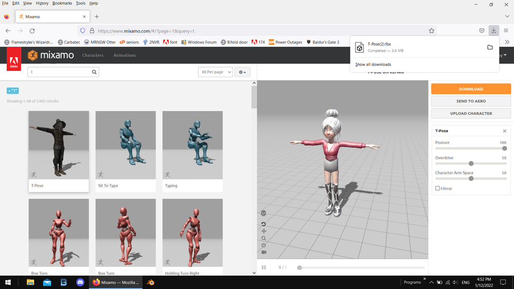

LEGEND , Apr 22, 2022 Apr 22, 2022
two issues stop the rigging; her shoes are actually joined together and her arms join the bow at her back... once that is repaired she riggs well

LEGEND ,
Community Beginner ,
OMG you're a genius, thx you so much ❤️

LEGEND ,
Nov 29, 2022 Nov 29, 2022
1st your issue has nothing to do with this thread and the reason no one answered you is because posting a 'me too' post means no one sees it
anyway the key is this model is missing her groin as in there is nothing to attach a groin marker to
its also set too low and in the wrong pose but if you put something under her dress then it will work... let the girl be a lady

LEGEND ,
Nov 30, 2022 Nov 30, 2022
it needs more work but just to prove that is the issue

LEGEND ,
Sep 23, 2023 Sep 23, 2023
i would adjust the parts but she does rig when you do the things we talked about

LEGEND ,
Nov 20, 2023 Nov 20, 2023
@Teddy337347144y4kwhat you did wrong was having a head float above the body... all parts must be attached so just add a neck

LEGEND ,
Jan 11, 2024 Jan 11, 2024
yes the hair has a few issues;
It covers the other markers
its very complex and it is mistaken for body parts
when you remove the hair she rigs so you 4 basic options;
  1. just remove it
  2. use some other tool to rig it
  3. remove the hair until the model is rigger then put the hair back or
  4. change the hair
