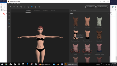

Hi
I was able to get Fuse on Steam and rig/animate them on Mixamo.
But I'd also like to use some of the existing models from Mixamo.
Mixamo only exports fbx and dae.
Fuse only imports .obj.
I tried to convert the mixamo animation fbx (with skin) to .obj using the Autodesk fbx converter but it failed with the error message "not enough parameters".
Sort of ironic that models created in Fuse and rigged in Mixamo can't be imported back into Fuse?
Or is there an easy way, without Blender, to convert Mixamo into an .obj that can be imported into Fuse.
