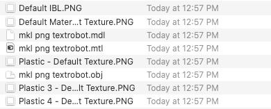

Hey mate! Built simplr robot in Dimension, loaded it to Mixamo, worked perfectly, except not textures? I tried to zip all the files bleow but get the error in Mixamo? any Advice? many thanks

unsupported file type will likely be the Obj file has translucence or glow
try load the model into Photoshop and exporting as wavefront Obj with Png textures
or share the model and I'll test it

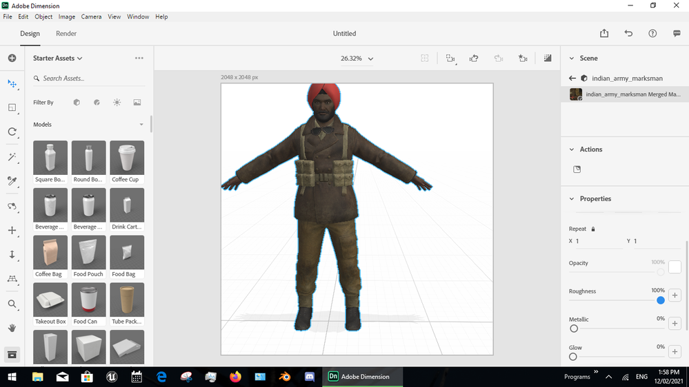

  • take another look at the first screengrab I posted of your Dn file... it shows you what you have to change in order to export a standard Obj file for uploading to Mixamo... Mixamo allows Obj, Fbx or zip files only so you can't upload a Dn file
  • so you want me to teach you 3D and the difference between rbg Nvidia textures and Apple Metal textures? I know you use Dimension so will show you the workflow I use and how to spot different drivers because Adobe changed from Nvidia to Metal and it buggered up everyone that just downloads updates without asking why
1 download character and animation1 download character and animation2 test it works2 test it works4 test it4 test itupload it back to Mixamoupload it back to Mixamonew animationsnew animations
Votes
LEGEND ,
Feb 11, 2021 Feb 11, 2021
Copy link to clipboard
Copied
  • metal textures in Adobe Dimension... how to spot them and how to fix
  • how to spot in older versons of Photoshop and how to fix... if you have the current Photoshop it should look ok but will be shinny in Mixamo because Mixamo is old and can't read the new file types
Screenshot (4453).pngScreenshot (4454).pngScreenshot (4457).pngScreenshot (4459).png
Votes
LEGEND ,
Copied
sorry to give you screengrabs but the problem is I don't know what build of Photoshop or whatever else you are using and how it looks at your end will be different if you use the wrong build... actually its just a matter of fixing the way the light is rendored as Apple metal drivers tend to look more shinny
download animationdownload animationtest ittest itedit the modeledit the modelmake a single texture (note current Photoshop used here)make a single texture (note current Photoshop used here)how to spot the wrong textures usedhow to spot the wrong textures used
If you are working in Fbx then Dimension will load your downloaded animation file and allow you to make edits which you can then reupload or just swap out... it depends on how old your software is as to do you need to convert back to rbg or stay metal
  • a texture is a image [sometimes called a map] and Mixamo looks for image files... many of the new materials you get with Dimension are just the default material (even if they call it plastic) and they just have basic info stored in the mtl file i.e, no actual texture images are exported from Dimension when you use these materials and mixamo can't read a Obj that does not have textures... check the Obj file Dimension exports out for you, no images = pick something else or don't use Mixamo
