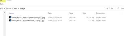

Hi Stephen. Okay, I am posting my issue again, and I think I can demonstrate the problem more clearly this time because I am not working on other things at the same time.
Let's forget about legacy Export As. Its not broken, and I was just using to demonstrate that Quick Export is, after version 23.3.
Instead, today, I installed PS version 23.2 and used the Quick Export maximum settings there, then re-installed 23.3.1, and used the Quick Export maximum setting there. Below are the results.

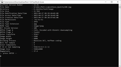

And here is the exif of each one:
Also, here are the settings used. First 23.2 at maximum (100), second 23.3.1 at maximum (7):
Okay, and the visual evidence. First, PS23.2 version, Quick Export 100 (maximum):
Second, PS23.3.1 version, Quick Export 7 (maximum):
Its obvious that the second is much more lossy than the first, as one would expect from a file so much smaller than the first.

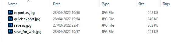

clifton, there is something wrong with your settings somewhere. I'd recommend a preferences reset.
All four methods produce the same sizes at maximum quality (whatever that happens to be):
The only slight difference is Save As, which is slightly larger - perhaps due to metadata, which the other three strip. Note the original date is retained.

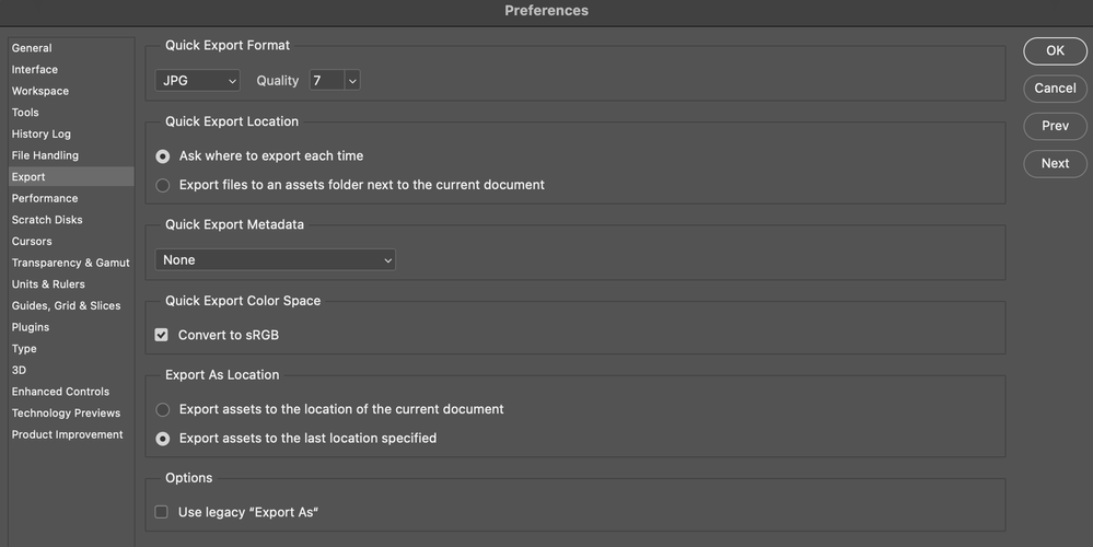

When I toggle on and off the Legacy option in preferences, and no need to restart, the differences are pretty clear:
Use LegacyUse Legacy
Use Legacy: scale in percentage up to 100%
Do not use legacy, the scale isn't percentage and maxes out at 7

The problem is that the results aren't identical, which is obvious if you just look at my example. The 1-7 slider does not scale to 100% quality when using Legacy Quick Export. It does do that when using the normal Quick Export, but not when using Legacy.
The maximum quality setting when using Legacy is 7, just like it is when using Normal. But "7" seems to mean something different to Legacy than it does to Normal. And since the UI won't let me set the value any higher than 7, even when using Legacy.
Saving settings after checking "Use legacy" and then re-opening the settings dialog doesn't make that slider go any higher than 7. Closing and re-opening Photoshop doesn't make that slider go any higher than 7.  That is what makes this a bug.
