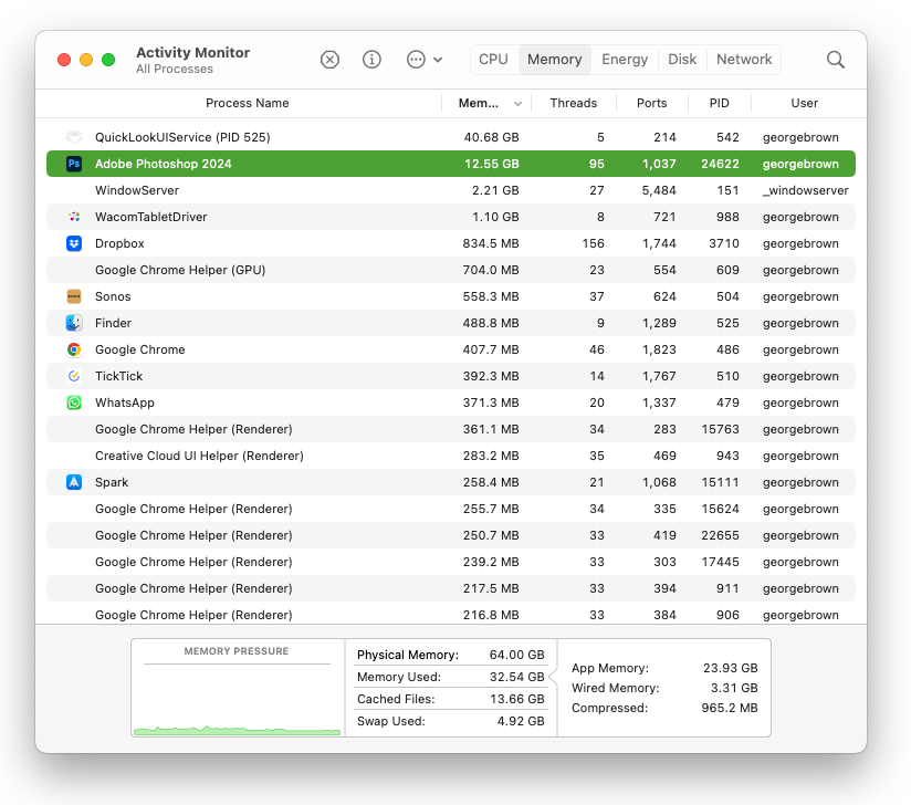

Mac OS X - 14.1 (23B2073)
Photoshop 25.3.1
Apple M3 Max (64GB RAM)
I'm a freelance retoucher & I'm using Photoshop around 10 hours a day. The remove tool is pretty much instant for me, however about 3-5 times a day after repeated usage, I'll see the loading bar on a removal.
As soon as this happens, I know to save my work, as activity monitor over the next minute will show Photoshop suddenly using more & more memory until the app becomes unresponsive & only a force quit will fix this. If I have multiple files open I'll only get the opportunity to save one of them so it's a bit like playing Russian roulette with my job.
I'm not doing anything unusual or weird & my files aren't that big. The issue is consistent however.
I will grab screenshots of normal RAM usage & the issue as it happens & update shortly.

As of yet the problem hasn't happened again. However here's a bit more transparency on how I work & thus, the steps that eventually produce the issue. These are my settings, 'remove after each stroke' is turned off.
I select 3-10 areas with the remove tool I'd like to remove.
I then do hit 'remove.' I rinse and repeat this process.
When I open Photoshop it starts at a low memory usage however after each 5-10 strokes of the remove tool, about 1GB of memory is added to its usage. This continues as more strokes are added & has seemed to top out at 40GB usage.
So far since my post a couple hours ago I've not yet had a fully memory leak situation such as mentioned in the original post. (this morning though I had about 3 so its just a matter of time).
I'll update with more when a leak happens.
As promised.
A memory leak crash just happened. I'll be using Remove tool & then suddenly I'll see the loading bar at the top with no progress, this will not move. Activity monitor will then show a constant spike of RAM/memory (about 5GB+ a second) until it reaches about 200GB of memory & then Photoshop becomes fully unresponsive.
