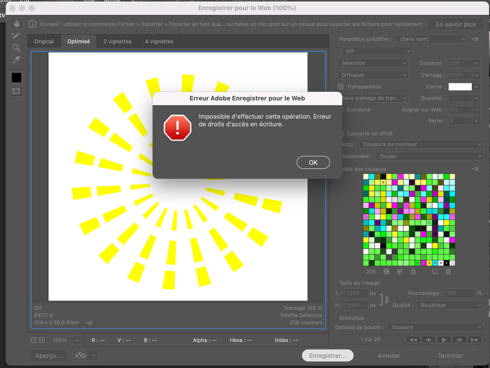

I am having a very problematic bug when I try to use the Save for web menu (I need it to export an animated GIF).
When I try to export I get the error message "write access was not granted".
I am using PS version 23.2.2 on a Monterey 12.2.1 Mac.

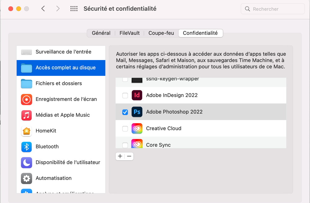

To try to fix it, I granted PS full disk access :

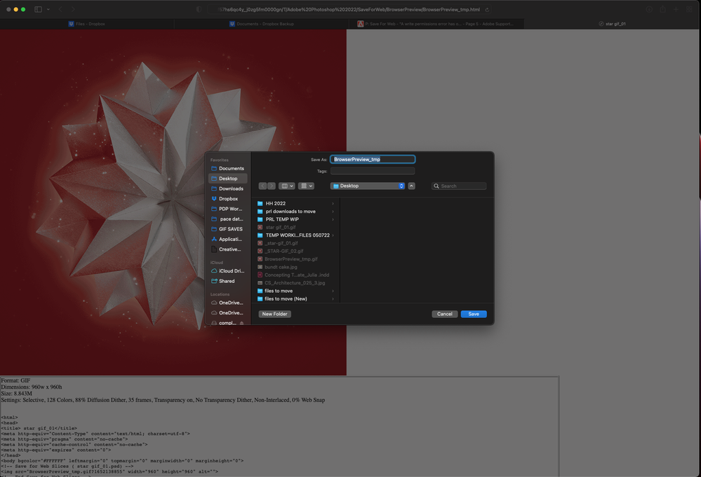

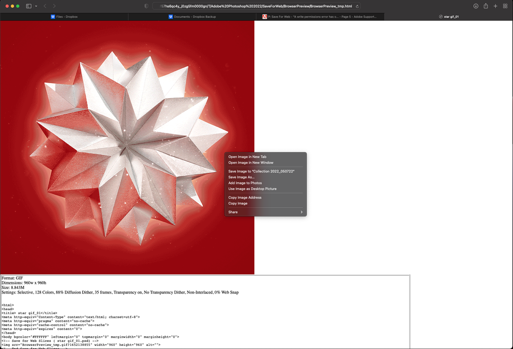

Working with my tech, we found a stellar workaround:
When exporting using WEB LEGACY, select Preview (this will open it up in your browser). From there, download it / save the file. File is full size render.
