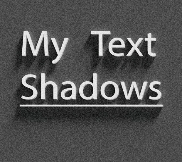

For grain use Add Noise but, get it looking good on screen then scale to your print. If you add noise at 300ppi it will probably be too fine to see.
As far as the long shadows are concerned - have you tried using Photoshop's 3D tools to do this.

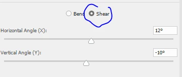

Below is a quick and dirty example - I've not tried to emulate the font but it is just :
1. Text - extruded to 3D and the extrusion sheared so that the sides show without distorting the straight on camera view
2. A background grey layer with some noise taken into a 3D Postcard layer
3. The two 3D layers merged into one and the infinite light adjusted to cast a shadow from the text onto the postcard
(I also added a second light to light the extruded sides of the text but that was set not to cast any shadows)
4. The 3D layer rendered then put into a smart object and some further grain added with the Add -Noise filter
Dave

davescmCommunity ExpertCorrect answer
March 2, 2017
Dave
