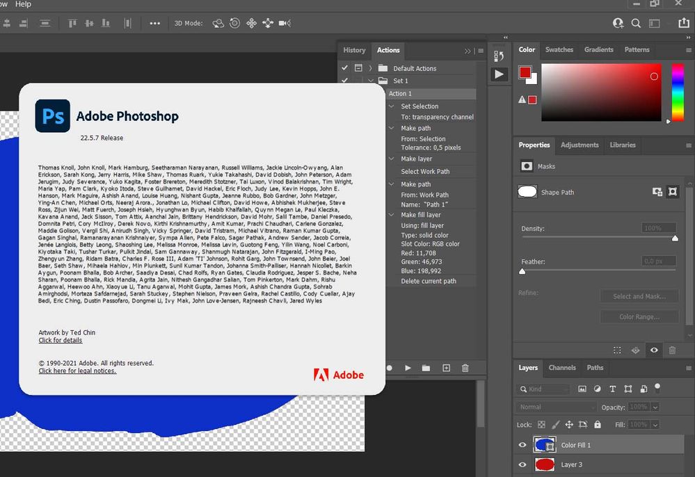

Community Expert , Apr 22, 2022 Apr 22, 2022
Here is my action, test it https://drive.google.com/file/d/1XNb3ZbzO8Tj4IYCr2ssfLs9ADG0cLHxt/view?usp=sharing
You must have selected layer with pixels and transparency on that layer like paint with brush on blank transparent layer then run action.
Community Expert , Apr 28, 2022 Apr 28, 2022
@Samuel_PFD – As you were originally trying to get code to work, here is a version of the action from @Bojan Živković converted into an action via xbytor's xtools:

Per your instructions, running 22.5.7 version of Ps. I have selected layer with stroke drawn on it (with transparency around stroke). Script is creating empty path and shape layer without anything on it, so to speak empty shape layer.
I am able to record action with following steps:
  • Create selection from transparency on selected layer
  • Convert selection to path
  • Create new blank layer
  • Create new Fill Layer with path selected in the Paths panel what will create new shape layer in essence
  • Delete path
With the rest I can not help. Version of Ps is 22.5.7.
To what you see above add Select path >pathname< before deleting it.

It works, no clue what you've done differently, but it works!
So thank you.

Explorer ,
Amazing, I was thinking of doing the same thing (but with more work). Are these the tools you are referring to? http://ps-scripts.sourceforge.net/xtools.html
I'll adapt your code with mine, to remove the first layer, and set color from foreground color, but this is perfect.
I'll mark it as correct when I try it out too!
Apologies, I should have posted the link as the one that you found is old:
EDIT - Here is 2.3, I incorrectly posted 2.2 before:
https://sourceforge.net/projects/ps-scripts/files/xtools/v2.3/
Explorer ,
I think the issue (or part of the issue), why it didn't work for me was, that I set the shortcut as Ctrl + Alt + Shift + Z.
So it probably interfered with undo, or something like that.
I've also noticed, that "foregroundColor" sometimes returns a CMYK object  instead of HSV? What's up with that.

People's Champ ,
I have a question. Why are you always creating an empty layer? What is this for?
To ensure nothing will mess because when you have empty layer + path selected + fill layer then you will get shape layer. It is habit, and probably secure option. I got there somehow through testing and experimentation in the past (I guess).
