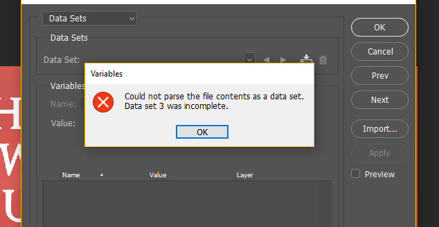

Ok, I just tried to make data driven graphics option but when upload csv file there is error message popup please see attached?
also this will work on Photoshop action to automate this process?
May 14, 2017 May 14, 2017
Seems the process does not like your CSV file does the first row identify the template layers variable names?

Yes I just changed first row to template text name but it this time same error message?
Explorer ,
"Data Set 3 was incorrect" it this time, I just put template layer name for quote and author at csv file's top row...

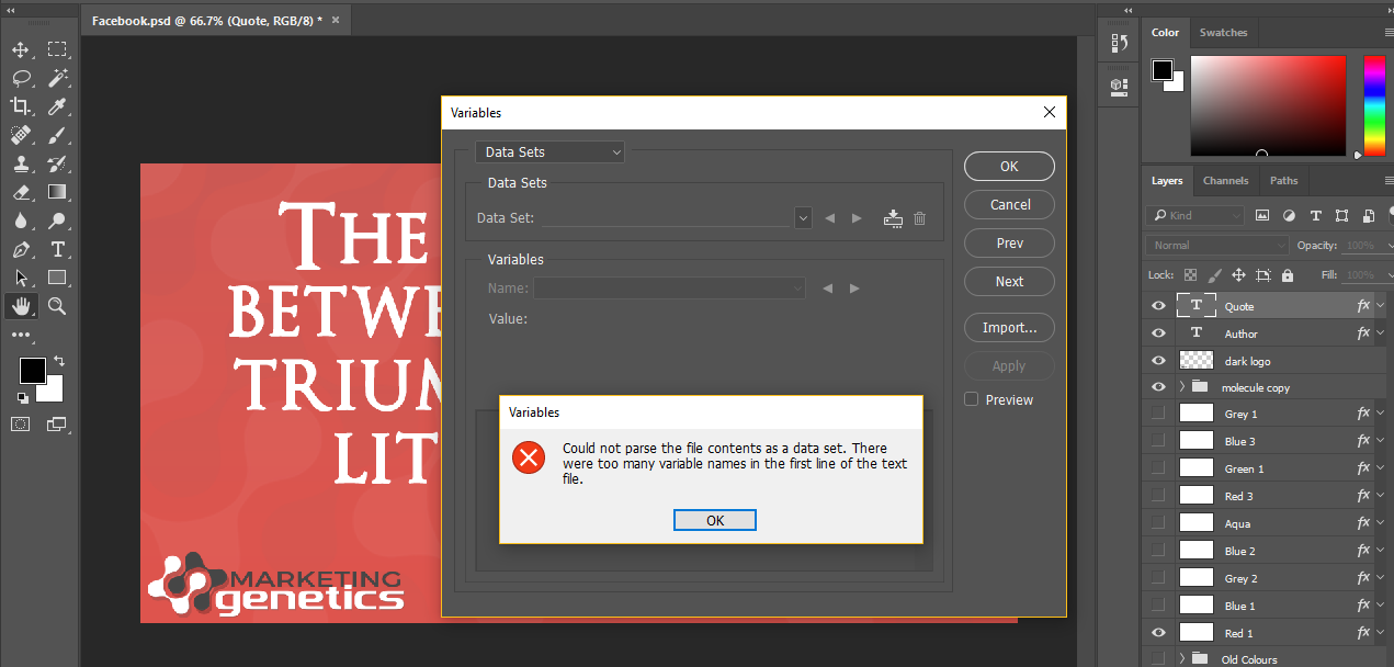

Sorry for delay, I have tried every thing but csv file is not seems working?
Explorer ,
May 19, 2017 May 19, 2017
Still getting the same error could not parse the file contents as a data set
Any clue?

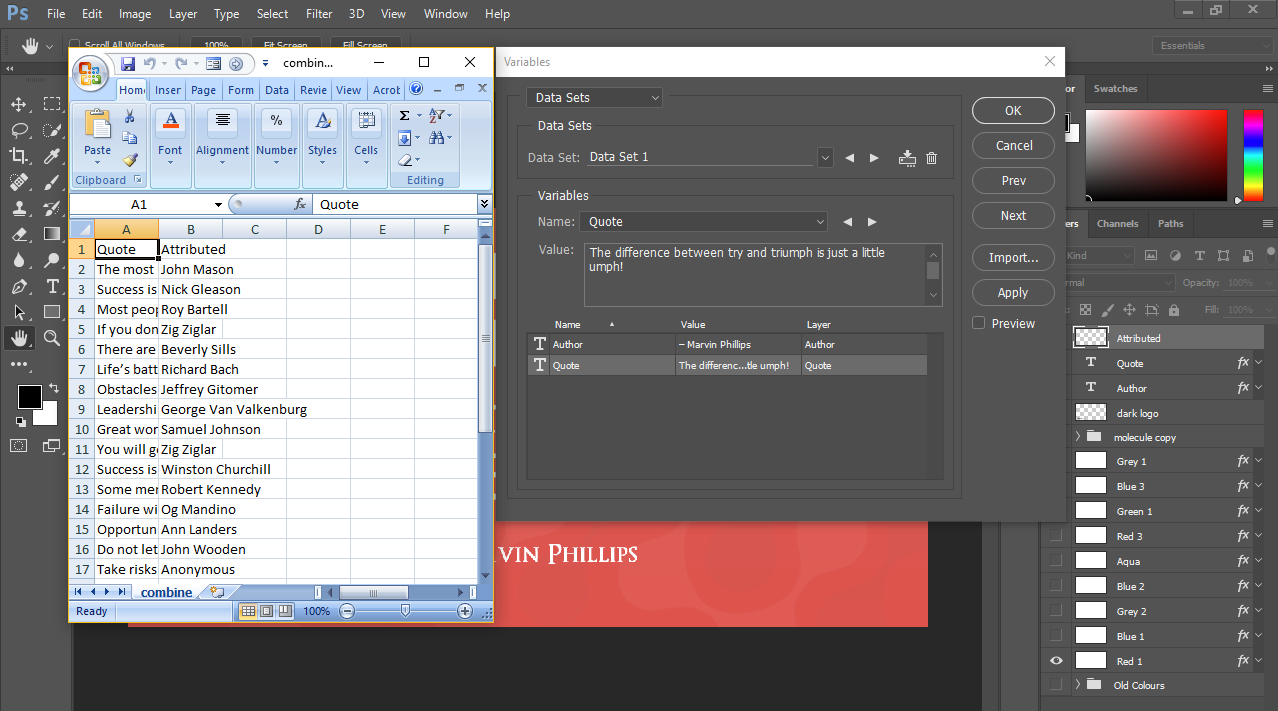

mirza5313  – I had some issues with your CSV file.
I added a new row above the existing text, then added column headers (Quote, Attributed). Notice in my screenshot from post #6 that I also used a column header. The first row column header is only a label for use with the variable merge, it is not used as content. I also selected column C and deleted it, there may have been a garbage invisible character in it (the clue being that there is no dataset 3, you should only have 2 columns/datasets).
I used these column header names to define the text replacement name that will be used for the variable.
Then all worked fine:

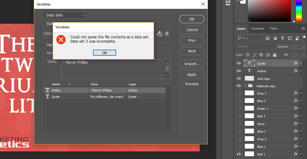

Thanks Stephen_A_Marsh I just added columns at top of the csv file i.e Quote and Attributed, also new layer with named attributed....
but error message : could not parse the content as a data set?
I know there is some miner mistakes may be adding new layers? I am sorry I am new in this fields of Variables
May 20, 2017 May 20, 2017
Did you delete column C?… Or conversely, copy column A and B and paste into a new spreadsheet, then save the new spreadsheet as a .csv and try importing that.
You should only have two columns, each with a header and each header is mapped to a layer.

Yes i have copied two columns and past to another file and save as .csv file when import new .csv file error message data set set 3 was incorrect
I just spent more time looking over your original CSV…
I did not look closely enough before, apologies!
You have quote marks, these are lost when opening into a spreadsheet.
You also have multiple commas, this will not work with .CSV so you will need to use TAB delimited instead.
You may also need to change the internal double quotes to single quotes, or use single quotes outside and double quotes inside to avoid having two sets of double quotes (hope this makes sense).
Do you know what text encoding and format you are saving the text file into?
And finally, you may need to consider the following:
Prepression: Photoshop – Variables & Leading Double Quote Marks
Due to the “complexity” of your source text file, you are having more issues than may be considered “normal”.
