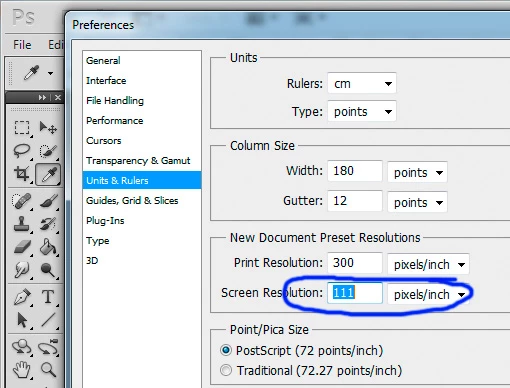

Semaphoric already gave you the answer, but maybe it's easier for you, with an image:
You need to find your screen ppi or calculate it by yourself and enter it there. If you set ps up this way and you click on "print size" when in zoom mode, you'll get a very good result.

If you know what the native resolution of your display is, you can enter that in Edit > Preferences > Units and Rulers > New Document Preset Resolutions > Screen resolution. If you view the image on another display, though (say, connecting your computer to your large-screen HDTV, or on another computer), you'll be back to square one.

I've had this same issue and by going into the prefrences > screen Resolution i was able to get it ALOT closer... its still not 100 % but its close enough...
my 2"x2" comes out about 1.8"x1.8" on screen
