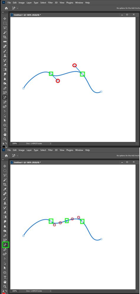

I am a 4th year IT student, and for my final year project I am making an image editor application using Machine Learning. So in my project I want to include Adobe Photoshop's Add Anchor Point Tool. So can anyone help me by guiding me that how I can train my ML mode using Anchor Points? And in the final output if the user want I can show him anchor points.

 Concept?  There is the math.  You have a line that is possible curved any which by control points on each end some formula that determines the path  line follows. To add a control point you cut the line into two lines segments there are now three control point that set the path segments two line segment now follow.  The two paths segment  replicates the Path the Single line's path segment had.  You are changing  the number of control points a path has. Your Machine Learning may want to adds a control point so it can adjust  part of an existing  path to follow the path of  beats of a different drummer.  When I add a control it is because I what to change an existing path. With my leaning  I normally look for control points that I can remove  to make the full  curved path smoother and better.  In my mine its best to make paths with as few control points as you can. It is easier to make a good circle path with four control points then circle with 10 control points. A machine may to able to precisely position and set those 10 control point my 80 year old hands can not.  Photoshop is also a pixels editor with square pixels.  Would 10  equally space  control point land on a pixels that are squarely on the circumference. I would guess not.  Why would your  Machine Learning want to add control point to keep  an existing path. I would think your Machine Learning would determine an existing path is not ideals would to modify it to improve its quality like I do.  How your  Machine Learning will do this is outside the scope of my mind. I just keep making adjustment till  I have a paths  I find acceptable.  I do not have an automated process I use brute force.... Photoshops vector tool gives me that force..
Paths are mathematical description  the line you see is the some size plot for  that mathematical description paths are scalable. They need not be limited to two dimensions

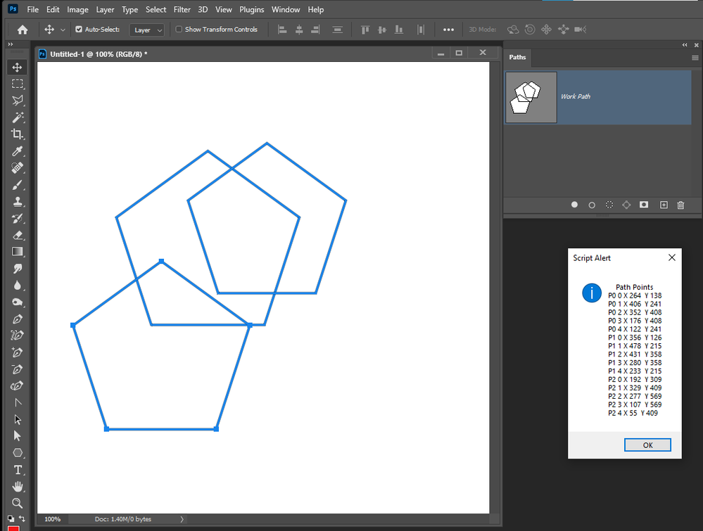

Photoshop Path Contol points are available with Photoshop scripting.
// 2015  John J. McAssey (JJMack)
// This script is supplied as is. It is provided as freeware.
// The author accepts no liability for any problems arising from its use.
// enable double-clicking from Mac Finder or Windows Explorer
#target photoshop // this command only works in Photoshop CS2 and higher
// Save the current preferences
var startRulerUnits = app.preferences.rulerUnits;
// Set Photoshop to use pixels
app.preferences.rulerUnits = Units.PIXELS;
var thePath = selectedPath();
if (thePath == undefined) {
	alert("No Path Selected");
else {
	var myPathInfo = extractSubPathInfo(thePath);
	var message ="    Path Points\n";
	for(var k=0;k<myPathInfo.length;k++){
		for(var j=0;j<myPathInfo[k].entireSubPath.length;j++){
			message = message +  "P" + k + " " + j + " X " +  Math.round(myPathInfo[k].entireSubPath[j].anchor[0]) + "  Y " +  Math.round(myPathInfo[k].entireSubPath[j].anchor[1]) + "\n";
	alert(message);
// Return the app preferences
app.preferences.rulerUnits = startRulerUnits;
////// determine selected path //////
function selectedPath () {
	try {
		var ref = new ActionReference();
		ref.putEnumerated( charIDToTypeID("Path"), charIDToTypeID("Ordn"), charIDToTypeID("Trgt") );
		var desc = executeActionGet(ref);
		var theName = desc.getString(charIDToTypeID("PthN"));
		return app.activeDocument.pathItems.getByName(theName)
	catch (e) {
		return undefined
////// michael l hale’s code //////
function extractSubPathInfo(pathObj){
    var pathArray = new Array();// each element can be used as the second arugment in pathItems.add ie doc.pathItems.add("myPath1", [pathArray[0]]);
    var pl = pathObj.subPathItems.length;
    for(var s=0;s<pl;s++){
        var pArray = new Array();
          for(var i=0;i<pathObj.subPathItems[s].pathPoints.length;i++){
             pArray[i] = new PathPointInfo;
             pArray[i].kind = pathObj.subPathItems[s].pathPoints[i].kind;
             pArray[i].anchor = pathObj.subPathItems[s].pathPoints[i].anchor;
			 //alert("Anchor " + pathObj.subPathItems[s].pathPoints[i].anchor );
             pArray[i].leftDirection = pathObj.subPathItems[s].pathPoints[i].leftDirection;
             pArray[i].rightDirection = pathObj.subPathItems[s].pathPoints[i].rightDirection;
        pathArray[pathArray.length] = new Array();
        pathArray[pathArray.length - 1] = new SubPathInfo();
        pathArray[pathArray.length - 1].operation = pathObj.subPathItems[s].operation;
        pathArray[pathArray.length - 1].closed = pathObj.subPathItems[s].closed;
        pathArray[pathArray.length - 1].entireSubPath = pArray;
    return pathArray;
JJMack
