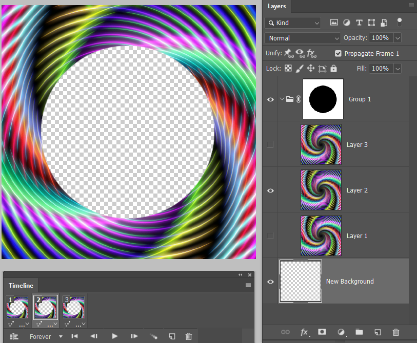

It is 'reasonably' straight  forward combining a frame an animation and a still image, but will all sorts of provisos.  If the GIF is to remain as a rectangle occupying part of a larger still image, then no problem.
This is a simple frame animation 500 pixels square.
I've done two things here
  1. Increased the Canvas size from the bottom right corner
  2. and placed the three GIF layers in a group for convenience.
This gives room to expand into.
I've added a new layer BENEATH the GIF layers.  Remember higher layers hide lower layers
And I have put a rainbow gradient in the new layer.
We could have gone in another direction.
Instead of adding Canvas size, we could group the layers as before, and add a layer mask.
By filling part or the layer mask, we punch a hole through it, exposing the new layer we place beneath it as before.
I'm not going to bother adding content to the new layer, because you'll be getting the idea by now.
