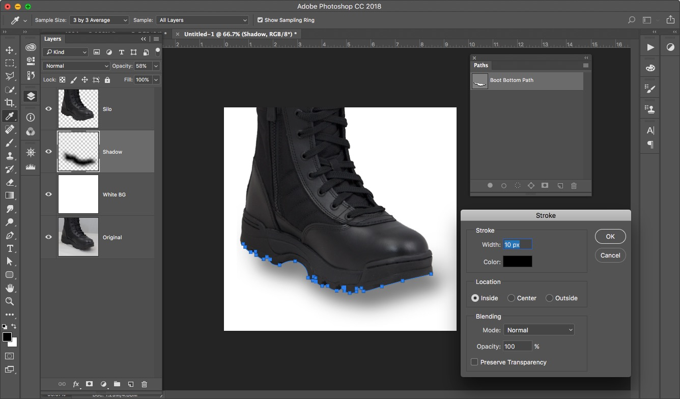

There are so many ways to add a shadow... I tried this as a test to see how it would look
1. Make a silhouette using the Quick Selection tool
2. With the boot selected create a new layer ? CMD J
3. With the Pen tool trace the bottom of the boot and save the path
4. Create 2 separate layers below the boot
5. Stroke the Path on the layer directly below the boot with a soft round brush (size 150) to make a shadow
6. Fill the layer below the stroked path with white
7. Position the Shadow correctly making sure that it is going in the right direction and change the opacity to 50%
8. Use the eraser brush to finesse the shape
This might not be a practical technique for 150 boots... it was quick to do though.

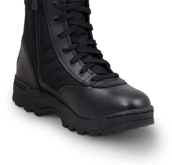

First of all: start with a properly exposed image - one that could actually have a white background! Like this:
Next, a realistic shadow isn't uniform. It's very dense and sharp where the object hits the ground - much lighter and more diffused as the distance increases. So you need to build up using several layers with different brushes and opacities. This was actually done in five minutes:
