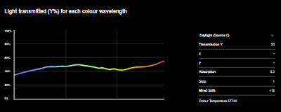

I use lighting gels and camera filters when photographing.  For instance, my polarising filter changes mired by +19, independent of the colour temperature.  I want the images I create using or not the filter to be at the same colour temperature independent of the lighting conditions.
Adjusting colour temperature is inappropriate as in most cases the colour temperature of the scene is unknown and probably unknowable.  For instance, I do not have a colour measurement meter for measuring my various flash guns and lighting units, never mind daylight.  Assumptions are a bad idea.

I am likely to be using Lee 239 polariser which has a published lumpy transmission curve
Obviously this will cause colour shifts across the whole spectrum and lightness.  The mired shift is single number which provides a compromise adjustment, and its calculation itself has number of compromises and assumptions.
