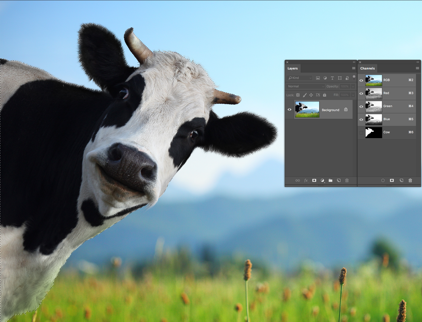

  1. When I select RGB in Channels (Ctrl + Left click) I get the dancing ants showing my selection, as it should.
    I have a selection—marching ants visible. (OK, not so visible in the screen shot, but they are visible on my screen). I have the RGB composite view selected.

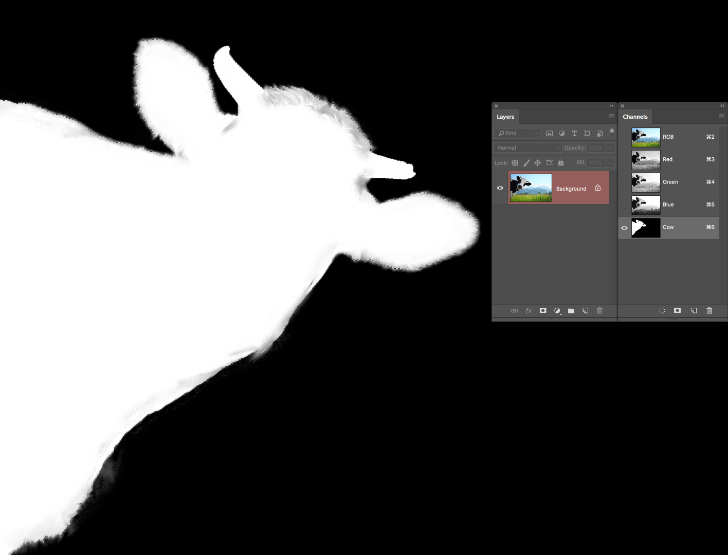

  2. Then save selection as a channel.
    I saved the selection as "Cow".

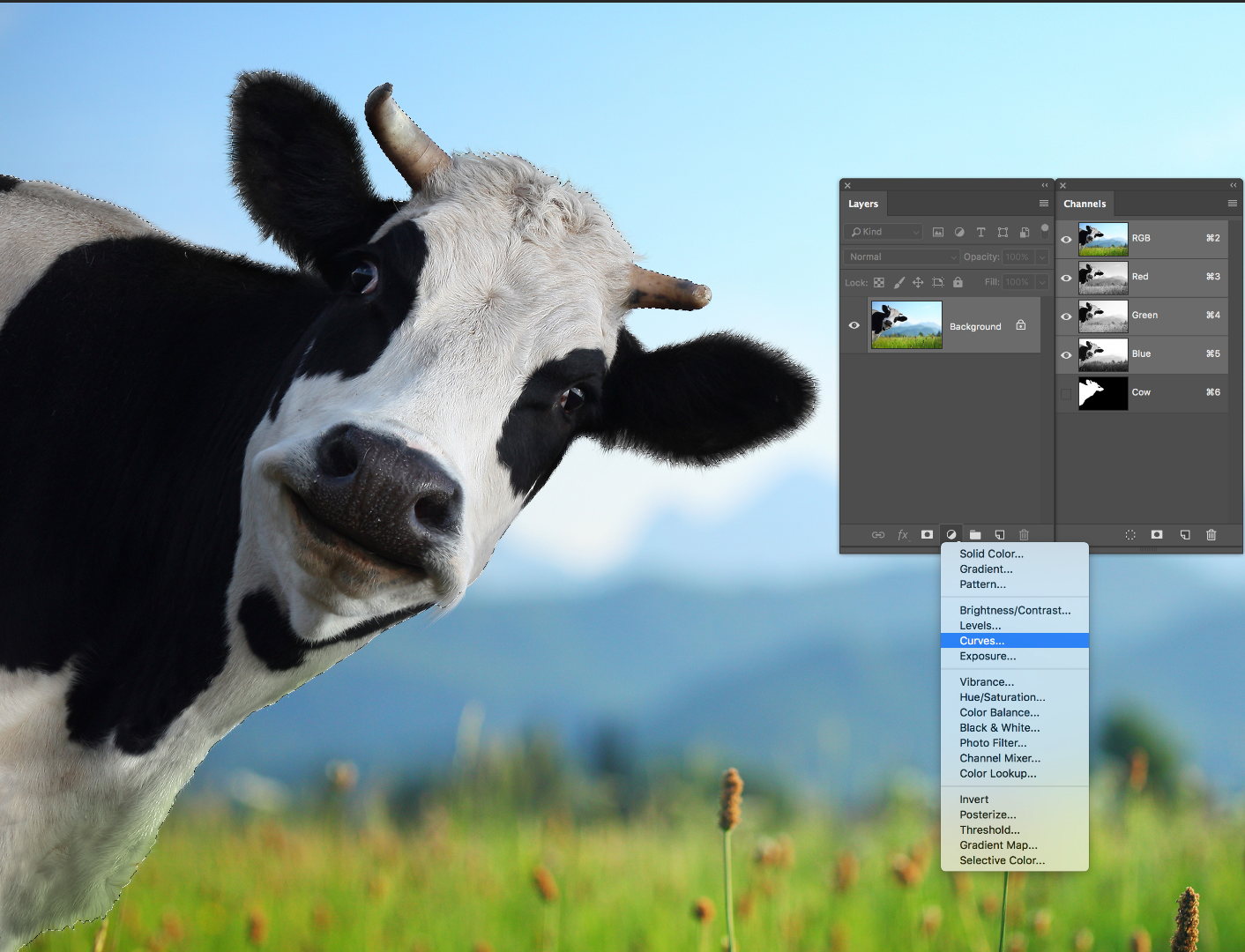

  4. Then I select 'Create new adjustment layer' at the bottom. From this I select the option 'Curves'.
    Back in the RGB composite view, select Curves from the Adjustment button at the bottom of the Layers panel.

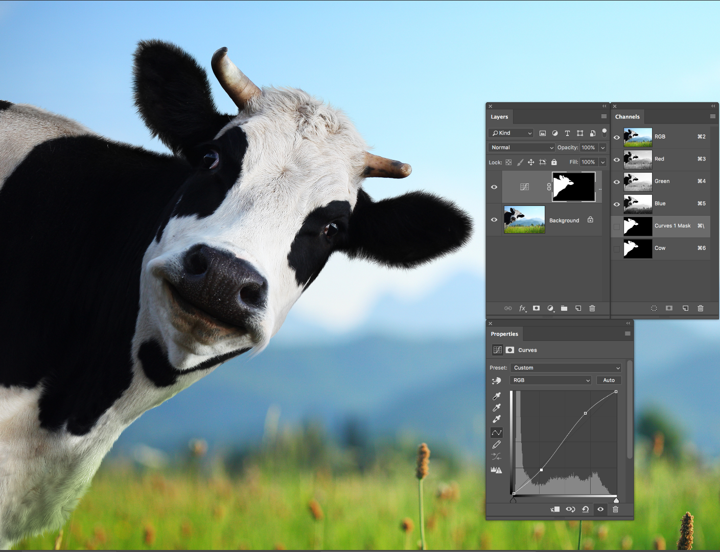

  5. When I select 'curves' from the list, the dancing ants (My selection) is removed and the whole photo is selected. Any adjustemnt then adjusts everything and not just my selection.
    At this point the marching ants will disappear, and a new adjustment layer with a layer mask that represents the original marching ants selection will appear above the selected layer. Adjust the curve in the Properties panel, and the mask ensures that it targets the original selection, and not the entire image.

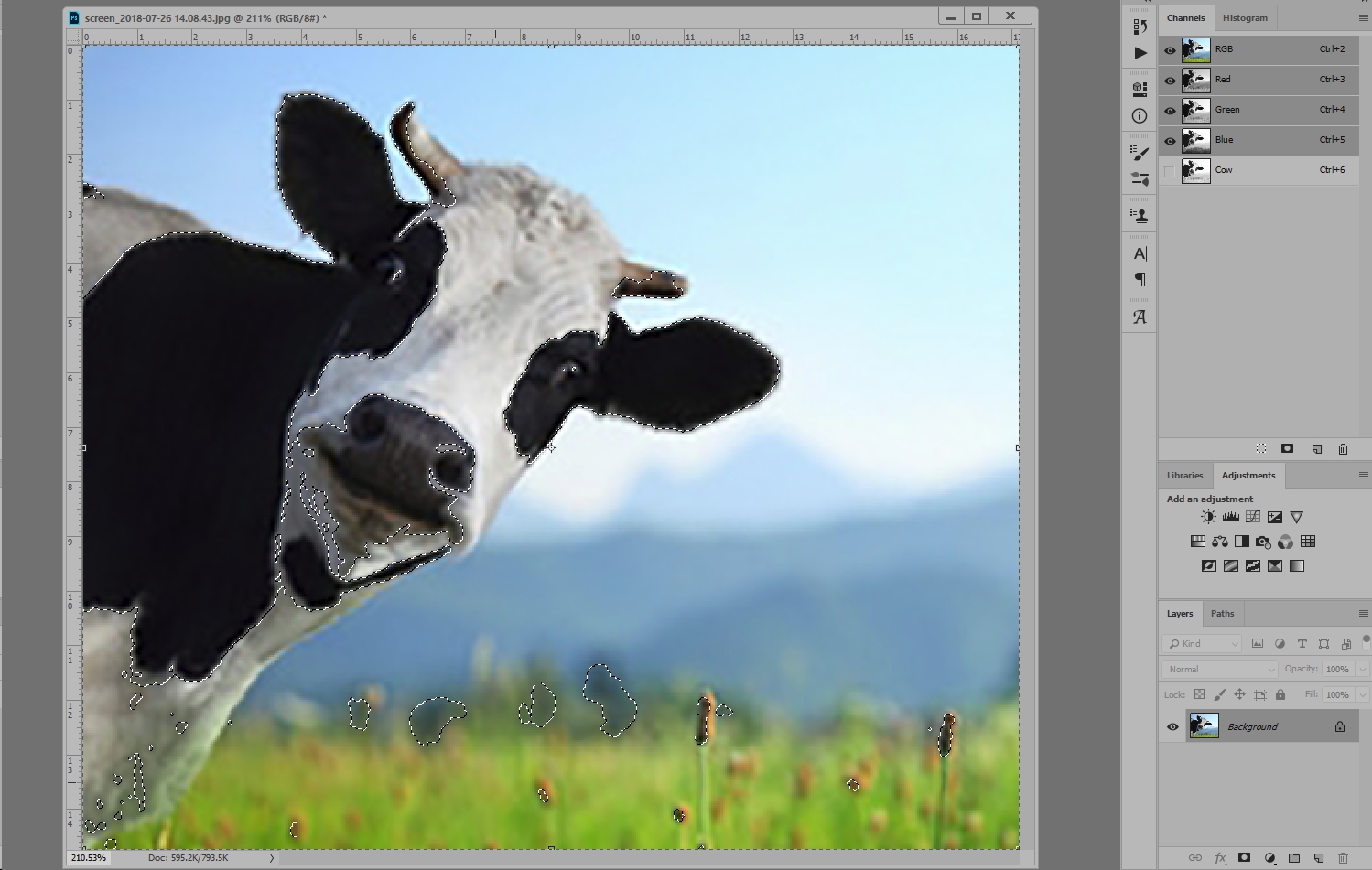

Notice my icon doesn't show as black and white as yours does. This is before I even select curves.
Also notice the marching ants are all over my image. (Different image quality)

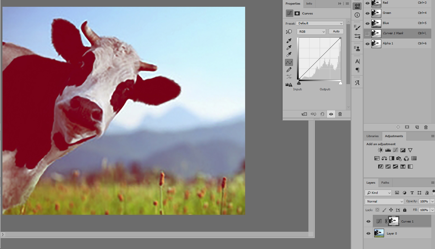

Mike I did as you said, but again the new mask isn't as per my selection. It selects the whole image.
My selection disappears.
Jul 26, 2018 Jul 26, 2018
What are you talking about?
The Layer Mask (Curves 1) and the saved Channel (Alpha 1) look pretty much identical.
