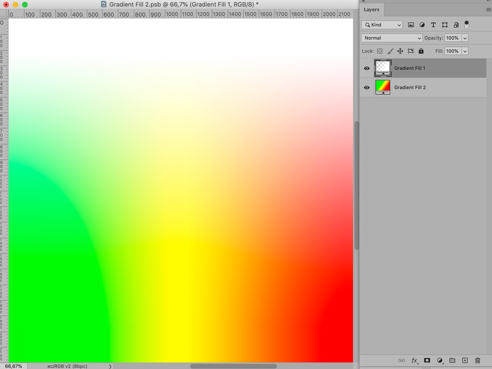

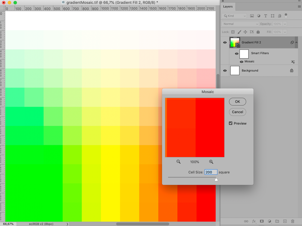

That does not bode well.
I suppose a combination of gradients with Posterize or (if the averaging isn’t too steep for your needs) the Filter Mosaic could be used.
But ultimately you might be chasing a mirage – human color perception has three »dimensions« so variation along two axis can only achieve so much … in the screenshots for example hue and luminance vary but saturation is »flat«.

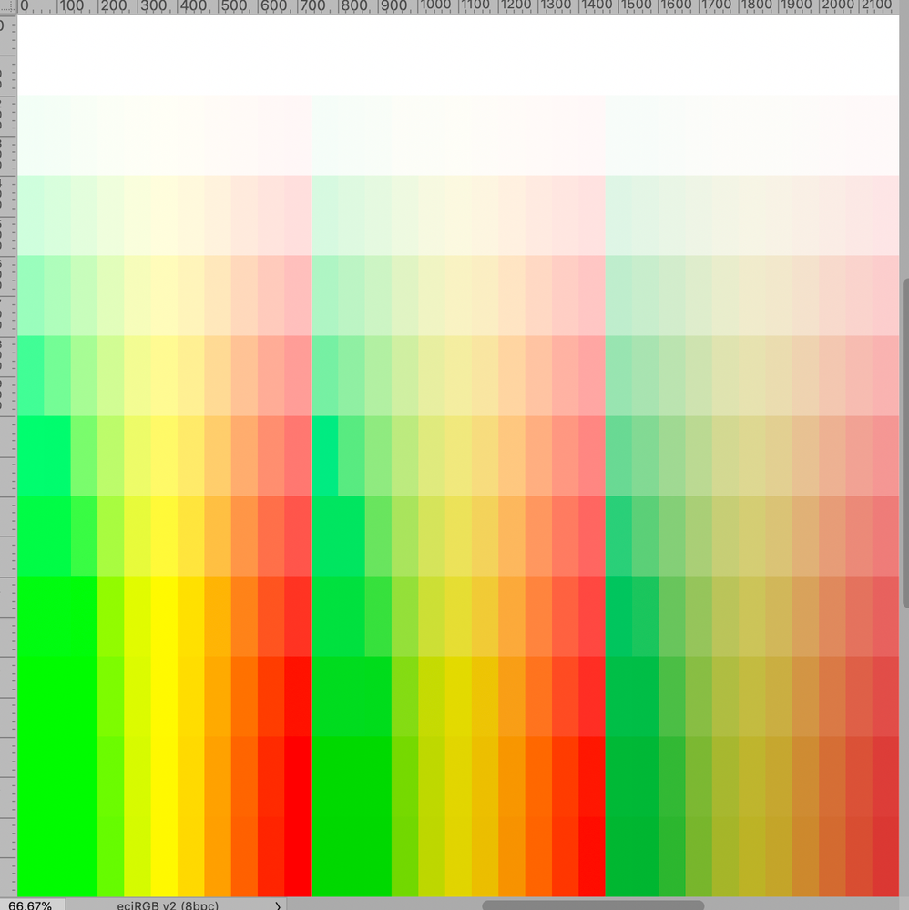

Edit: One could use multiple »repeats« for the third property.
