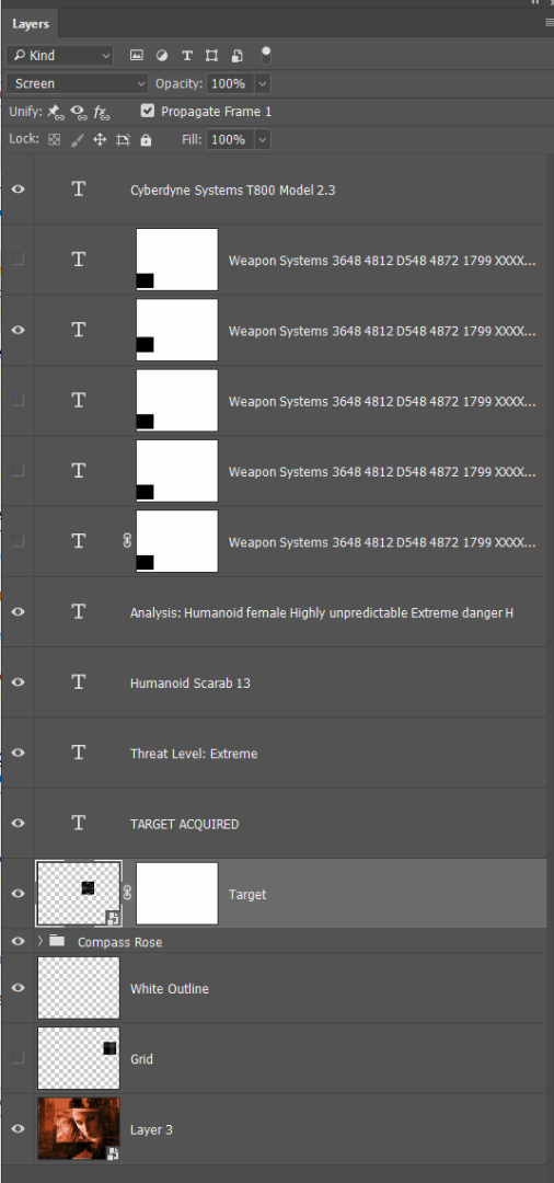

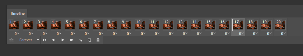

Set the Workspace to Motion and create a Frame animation
The background image will be on for every frame, and you can turn on the other layers as the frames progress, and move and turn them off and on again.
When you have simultaneous movement it is a good idea to group relative layers together.  Work out the animation for one group. The start at the first frame and turn on layers in another group as you work through the frames.  The start again for the next group.  It can get a bit complicated, which is why using groups is a good idea.
Some of the graphics are most often found as black on white background.  So Invert the layer and set Blend mode to Screen or Lighten (if you want white graphics like below.
May 10, 2017 May 10, 2017

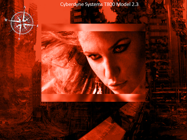

OK I couldn't leave it at that
So you create the layers and the frame animation, and go to each frame in turn, and turn on or off the relevant layer.
You can move a layer between frames, or in the case of the Weapon Systems move the layer mask, but you MUST unlink the mask from the layer (click to uncheck the chain icon)

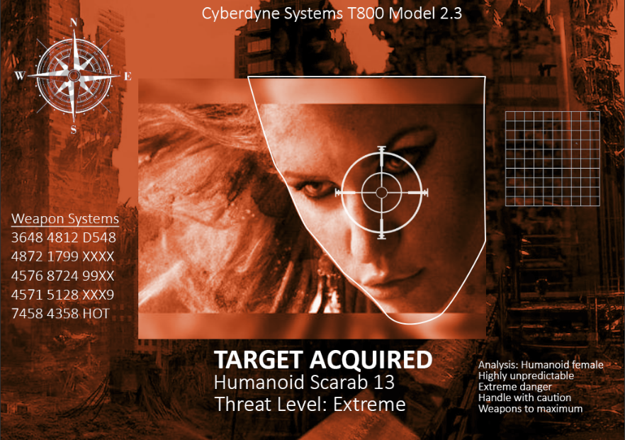

JJ, the head shot comes from the OP's forum profile page, so I assume it is a shot of her.  There are several shots of the same person.  It is on a separate layer to the decayed cityscape background, so a trivial matter to move and animate, but I went with the Terminator HUD rather than the extreme flicker in the OP's GIF.  The same techniques apply though, and can be used to move things however you want.
Incidentally, I picked up a new trick recently.  I used Step & Repeat to create the layers for the revolving compass rose, and added the layers to the frame animation using Create frames from layers, as you would.  The trick I was not aware of is that if you select all the frames and click on the New Frame icon, it duplicates them all.
The new frames will remain selected so you can Reverse Frames from the pop up menu, and have a sort of reciprocation, backwards and forwards animation.  I am sure it was obvious, but there is precious little information about frame animations, and it is largely a case of work it out for yourself.
So that was how I started this animation, and then manually added the other layers frame by frame.  But we might as well share the look and feel with the original
