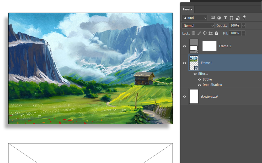

What I do instead is draw a path, then apply it to a layer as a vector mask (Layer > Vector Mask > Current Path). A vector mask behaves like a pixel mask: Any effects apply to the mask edge, so it’s straightforward to apply a stroke and drop shadow that work like you expect them to. As a vector mask, it’s easy to resize or reshape independently of the layer content.
In the picture below, I drew the path using the Rectangle (not Rectangular Marquee) tool set to Path mode (not Shape mode), then applied that as a vector mask to the bird layer (Layer 0). In the Layers panel, you can see that the Stroke and Drop Shadow effects are applied to Layer 0 as you would expect, limited by the vector mask edge, the way we wish frames would work.

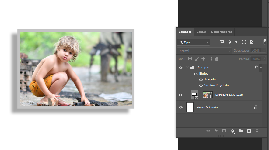

Ancelmo Alves
June 22, 2024
Maybe I don't understand what this is about. But for me, if I'm going to add effects to the board, I've always used it this way.
June 21, 2024
You can add a layer style to a frame by just converting it to a smart object and then using layer styles on that - so the bevel etc is applied to the frame - not ideal, it would be great if the frame tool had the feature to apply a style to the frame and / or content as well
