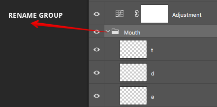

Advocate ,
Mar 13, 2019 Mar 13, 2019
Copy link to clipboard
Copied
On my mac it works fine
try this way
you must rename the group in Mouth
then select the Adjustment level
and start the script
Likes

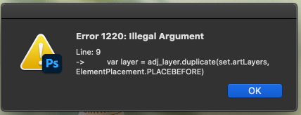

New Here ,
Dec 04, 2020 Dec 04, 2020
Copied
Hey Guys
This is something I need, but I get this illegal argument.
Any ideas?
Thanks
