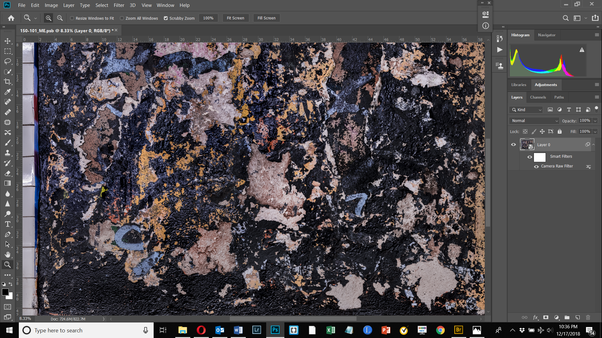

In this image, I don't like how the black background has a bluish cast beginning about 20% from the bottom of the image on the left.  By taking blue down in the Saturation tab in HSL Adjustments, I can get rid of the blue there but it does it for the entire image.  Can I make a Selection and make the adjustment for the Selection only?  I don't see a way to affect individual colors using Adjustment Layers, nor a way to apply the HSL Adjustment to a Selection,  Any suggestions would be appreciated.  Thank you.

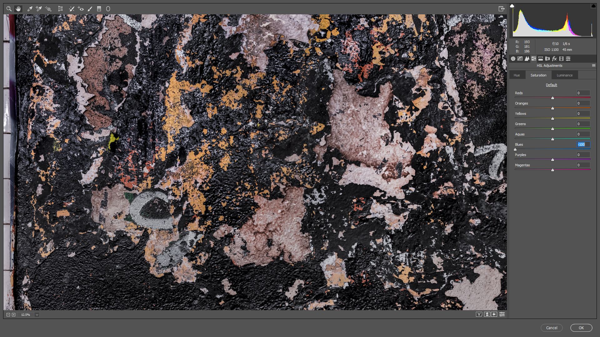

Thanks Bojan.  I am trying to target one color only - blue - in my selection, and I don't believe you have that kind of control using Adjustment Layers.  So what I did instead was make a selection, copy it to a new layer, make the layer a smart object, and apply Camera Raw as a filter.  Then I can target blue from HSL Adjustments>Saturation.  This working okay though creating a rather large file.  If someone has a better suggestion, I'm open to it.

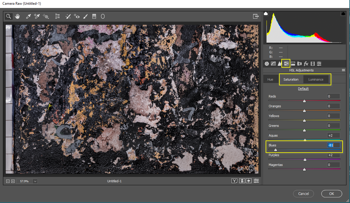

You've got to love the Camera RAW filter.  It is a one stop shop for so many things, and has been my go to solution ever since it became available as a filter.
So I have the HSL sliders selected, and I've reduced saturation and lightness for the blues.  If you are not sure which slider to use, move it all the way to the right to super saturate it, and test you have the right one.

Yes, this is what I had said I had done in my initial post, as well.  But the problem was that I wanted to target only the blues in the mid to upper left of the image, not the whole image.

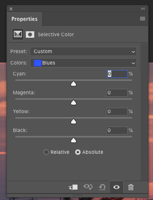

Try "Selective Color" in Layer Adjustments.
Advisor ,
Dec 19, 2018 Dec 19, 2018
Where is this panel exactly?  I could not find it.  Thank you.
