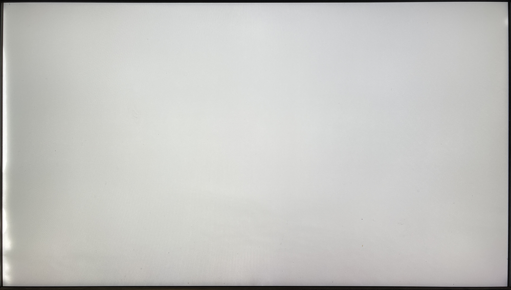

This is what it boils down to. This is what you don't want:
That is not a cheap monitor (a Dell U2713 actually). Check carefully before you buy.
Budget is budget. It means they're cutting corners somewhere. Usually, they do it where it doesn't show up in the spec sheet.

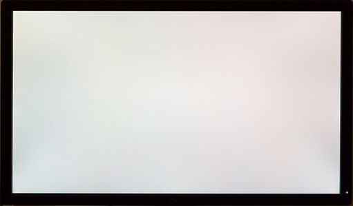

Did you really have to put that test up Dag?  Only it has not exactly made my day.  😞
Of course, I had to try it, and I got a shock!  This is a photograph taken with my phone, and I don't see the slight tonal variation looking at the screen, but that bright band on the left, and the smaller bright area top right, are very apparent.  I have no idea why I hadn't noticed it before, because it is suddenly the 'only' thing I can see.  This is a 32 inch BenQ PD3200Q that is a bit over seven years old now.
I was about to buy a new saw for my workshop, but I think that's going to have to wait. 😞   I don't do Pixel Peeping, but that's rediculous.  Right now I can identify with this very old video clip.
