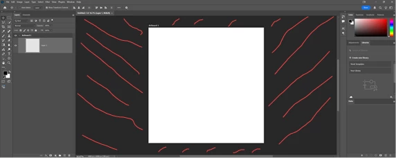

Is it possible to have an boder-less artboard? That means if I placed an image bigger than the artboard dimension, it will automatically increase it's dimension.

c.pfaffenbichler
June 8, 2025
Please post screenshots (obviously including the Layers Panel and not downsampled) to illustrate what happens as opposed to what you want to happen.
What role do Artboards play in the process to begin with?
Why do you need the Artboard to change dimensions accoring to a placed image (and what if you place more than one image)?
